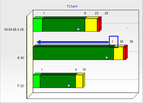

I have a stacked Horizontal Bar series.
I am using custom mark position to place the marks above the bar series. However, despite efforts, the text I want to display shows at the RHS of the bar. How can I show the value at the LHS of the bar?
The values I display are the actual start positions of the bar, so accordingly I want to show them on the chart where each bar segment starts.
MarksLocation := mlStart did not seem to change anything.

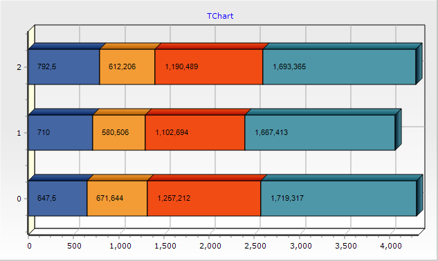

The MarksLocation property is thought to be used with the automatic positioning of the marks, not with the Custom positions you are using.
Ie:
var i: Integer;
  Chart1.Legend.Hide;
  for i:=0 to 3 do
    with Chart1.AddSeries(THorizBarSeries) as THorizBarSeries do
      FillSampleValues(3);
      Marks.Transparent:=True;
      MultiBar:=mbStacked;
      MarksOnBar:=True;
      MarksLocation:=mlStart;

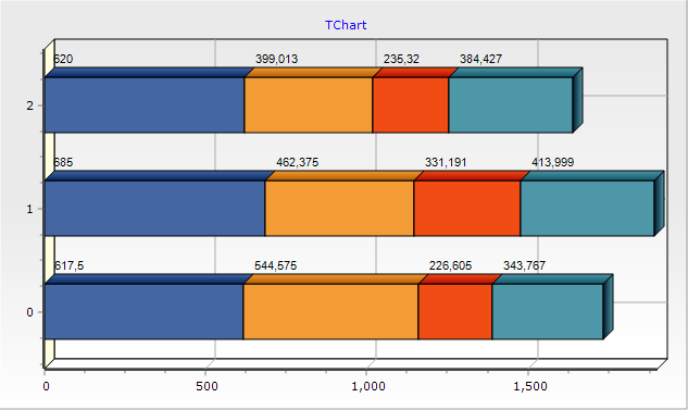

If you want to have your marks at the start but above the bars, you can use the Custom positions as follows:
procedure TForm1.Chart1BeforeDrawSeries(Sender: TObject);
var i, j: Integer;
    APosition: TSeriesMarkPosition;
  APosition:=TSeriesMarkPosition.Create;
  try
    APosition.Custom:=True;
      with Chart1[i] as THorizBarSeries do
        for j:=0 to Count-1 do
          APosition.LeftTop.Y:=CalcYPos(j) - 20;
          if i=0 then
            APosition.LeftTop.X:=Chart1.Axes.Bottom.IStartPos
            APosition.LeftTop.X:=Chart1[i-1].CalcXPos(j);
          Inc(APosition.LeftTop.X, Chart1.Canvas.TextWidth(ValueMarkText[j]) div 2);
          Marks.Positions[j]:=APosition;
  finally
    APosition.Free;
