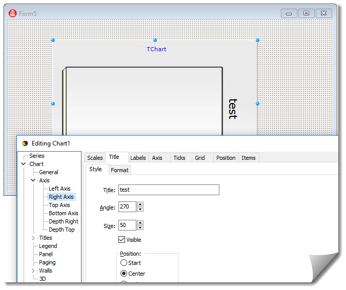

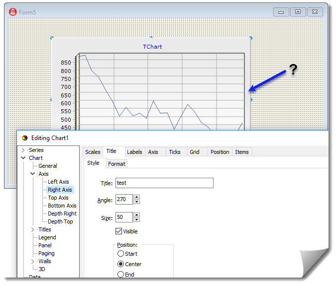

I am unable to get the right axis to appear or display any values once a series has been added.
Even the Chart Editor does not appear to allow anything to be drawn on the right axis.
The Right Axis is visible until I add a series. I guess this must be simple, but it has got me confused.

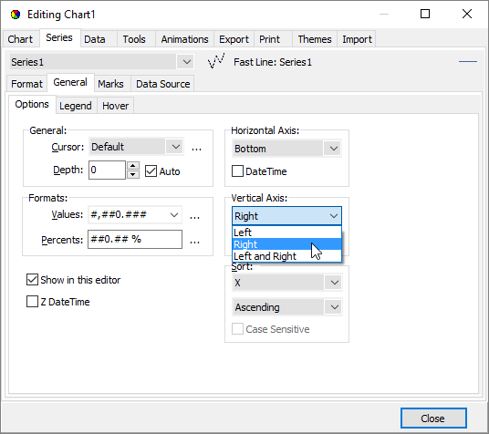

An axis needs a series visible with values assigned to it to be drawn. So, you have to assign your series to it:

Many thanks for the clarification. I didn't work quite how In expected as it introduced another intervening blank horizontal bar that I cannot use, but I now know how to implement it.
