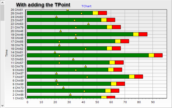

I want to draw a horizontal bar graph series and draw one of more points at some location over the horizontal bar.
The bars work fine until I want to add the points, and then only every second bar is displayed.
How can I show TPoints and also display every horizontal bar?

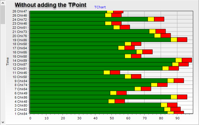

HorizBar series shows every bar when not adding the TPoint
Drawing the HorizBarSeries with adding a TPoint only draws every 2nd bar which is incorrect

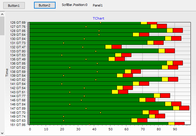

Post by VideoTrack » Fri Oct 12, 2018 12:09 am
Resolved by adding the Point series separately:

Add the Point series separately, not in the same loop that adds Horizontal Bar series.
