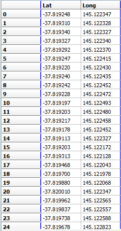

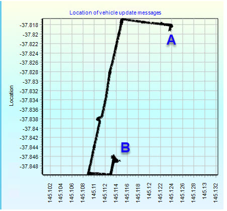

I have a series of Latitude and Longitude values that I wish to plot with a connecting line between the points. The points are recorded GPS data and all have a correct sequence order of data events. They were recorded from a GPS equipped vehicle traveling a known path and are in chronological order.
If I use a TPoint Series, the points are shown in the correct expected locations on the graph.
If I use the same data with a TLineSeries or TFastLine Series, the tracking line incorrectly connects to other points, giving an obscure and inaccurate plot.
There must presumably be a setting that allows the LineSeries to correctly interconnect the adjacent points instead of the erratic lines drawing that occurs.
Typical sample data is shown below

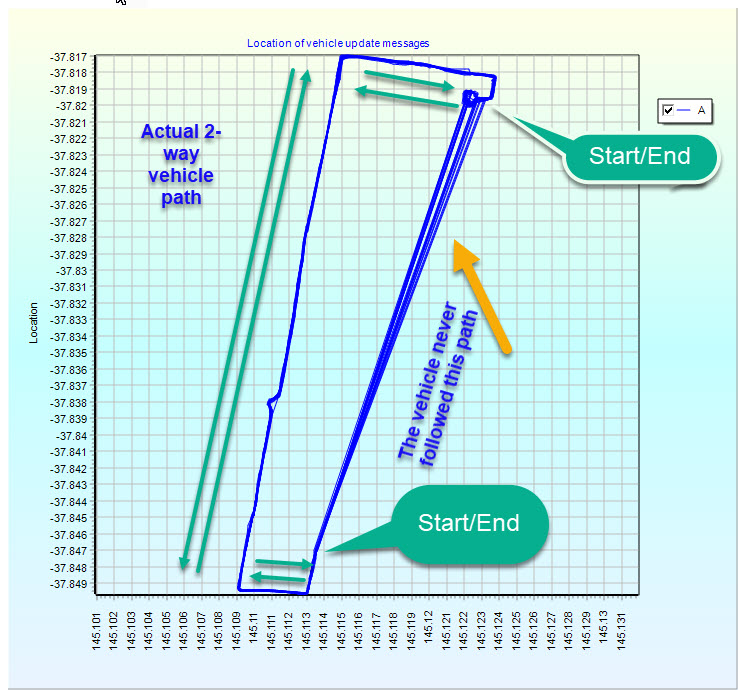

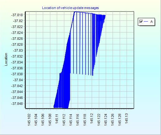

Thanks Yeeray, that's a minor improvement, but the start/end points lines are still being incorrectly connected. The graphic below shows the real vehicle path (green arrows). The graph has shown that, and also taken a shortcut, joining the start and end of the route with straight lines.Yeray wrote:Hello,
This probably happens because the values are x-sorted by default. You can disable this with:Code: Select all
Series1.XValues.Order:=loNone;
I tried also Series.YValues.Order:=loNone; but that did not make a difference

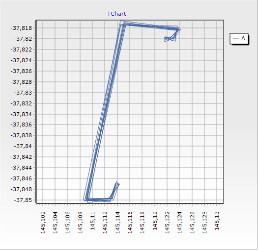

I've done a simple example trying to reproduce the problem here, but it seems to work fine for me.
Could you please modify the above or arrange a simple example project we can run as-is to reproduce the problem here?

I have found that the vehicle records when it goes 'online' and travels from A(north) to B(south). It then goes 'offline' while it tracks back to point A again, goes online, and then starts recording the track from A to B again. Sometimes it is two-way data and other times it is one-way only.
The unintended line was drawn when point A was the next available point after the previous last point B

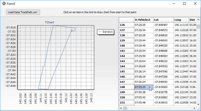

Click on a point on the grid to draw the chart to that point. The problem occurs at row 148.
If I can determine how to avoid plotting those points where the distance is excessive, this would allow me to solve my problem.
I have uploaded a sample program that reproduces my issue (ChartTrackingIssueWithSrc.zip).
Many thanks.

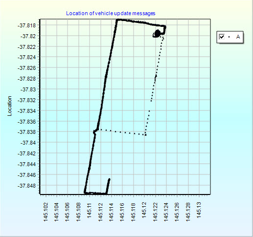

I have created a program that reproduces my issue.
It needs the csv data file to be copied to the same location as the exe.

Re: Plotting Lat/Long data as LineSeries gives incorrect display
The null points should do the trick for you. If you are using a TFastLineSeries, try changing it to a TLineSeries to see if it makes any difference.
If you still find problems with it, please try to arrange a simple example we can run as-is to reproduce the problem here.
- Newbie
- Posts: 17
- Joined: Thu Jan 04, 2018 12:00 am
Thank you
Both changing from FastLineSeries to LineSeries, and adding the null worked.
Your assistance is greatly appreciated
Dist := GetDistanceBetweenTwoLocations(ThisPt, LastPt, False);
if (Dist < 500) then
Series1.AddXY(ThisPt.X, ThisPt.Y)
Series1.AddNull;
