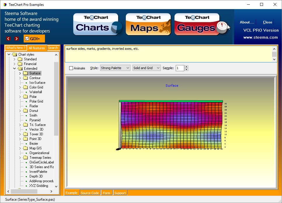

It gives a proportional look when you disable the orthogonal property. Here a surface at 50%:

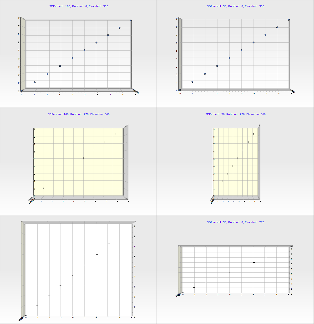

I've done a simple example using a TPoint3DSeries to try to identify what could be wrong in these functions:
And I got these screenshots, which seem correct:
uses TeePoin3;
var i: Integer;
Chart1.Legend.Hide;
Chart1.Aspect.Orthogonal:=False;
Chart1.Aspect.Zoom:=80;
Chart1.Axes.Depth.Visible:=True;
Chart1.Axes.Depth.Increment:=1;
Chart1.Axes.Bottom.Increment:=1;
Chart1.Axes.Left.Increment:=1;
Chart1.Chart3DPercent:=100; //50;
Chart1.Aspect.Rotation:=0; //270;
Chart1.Aspect.Elevation:=360; //270;
Chart1.Title.Text.Text:='3DPercent: ' + IntToStr(Chart1.Chart3DPercent) +
', Rotation: ' + IntToStr(Chart1.Aspect.Rotation) +
', Elevation: ' + IntToStr(Chart1.Aspect.Elevation);
with Chart1.AddSeries(TPoint3DSeries) as TPoint3DSeries do
Pointer.Style:=psCircle;
LinePen.Hide;
for i:=0 to 9 do
AddXYZ(i, i, i);
