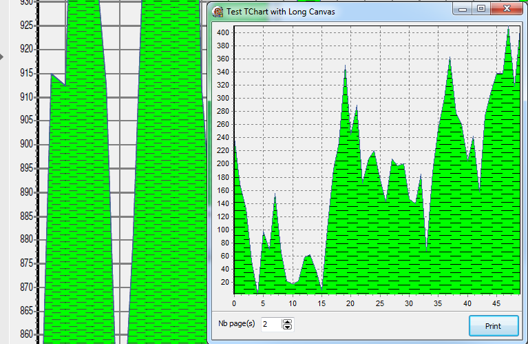

I have some problems when i want to print (in pdf throught PDFCreator in attachement) a chart with a serie region using a pattern.
1- Pattern seems to be zoomed and streched when canvas size is changed before print. The rendering is really not acceptable
2- Contrary to old version (Delphi 9 & Teechat v8.08), filled area seems to be a picture and not vectorial. Besides, pdf file size is very larger!

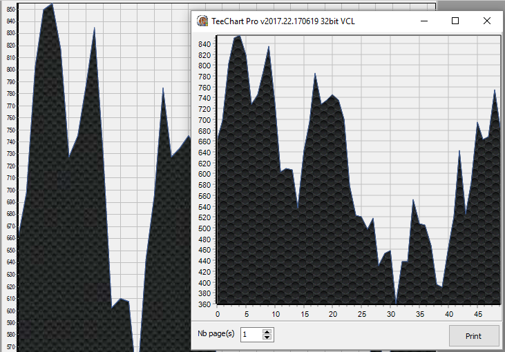

Re: SerieRegion with pattern - PDF export
This is what I'm getting with a new simple example using RAD 10.2 Tokyo, TeeChart v2017.22 and PdfCreator 2.5: If you still find problems with it, please try to arrange a simple example project we can run as-is to reproduce the problem here.
Here it is a screenshot comparing the chart and the pdf your project generates for me with v2017.22:
I'm trying to compare the result with TeeChart v8 but I'm getting an "29100 - Internal GhostScript Error" with GDI and I get a blank pattern in GDIPlus.

Below same example as previous with Delphi XE10.1 & TeeChart 2017.10:
Pattern seems to be streched!
Any idea or workarround?
Hello Anthony,
Any image pattern is likely to be stretched for a different output width/height ratio to the original Chart. I tried with a smaller image as brush pattern and note that it tiles so that may be a workaround. An alternative would be to use hatchstyle.
