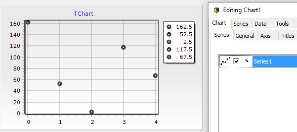

I have been using PaintSeriesLegend for drawing a series symbol in a checklist box that lists some pre-built series my user may select from. Unfortunately, the quality of the drawing is kind of poor. I think you use this a few places in the TChartEditor. For example, please look at the difference between the series as they are painted on a chart and chart legend versus the way they show up in the Series Tab and on the Data Tab in the TChartEditor. The series are pixilated and sometimes don’t even look correct. For example, please look at the donut style point series. It only paints a quarter of the symbol and is unrecognizable.

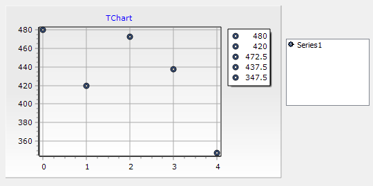

I see the symbol drawn with the PaintSeriesLegend method looks weird.
However, I'm not sure to understand what symbol would you like to draw in your checklist box:

Re: “Cleaner” way to draw series than PaintSeriesLegend
Post by sde » Wed Jul 26, 2017 3:44 pm
Yes, that is exactly it. So what I would like to be able to paint is the exact symbol as you see it on the chart or in the legend instead of what you see between the checkbox and the text "Series1" in the TChart Editor. For example if you added a point series to the chart you have, you would also see a difference between a smooth, nice looking series on the chart/chart legend versus a more pixelated looking thing in the TChart Editor. PaintSeriesLegend provides what is showing in the TChart Editor. So I was wondering if there is another procedure or easy way for me to paint a series symbol that will look just like the symbol would look on the actual chart/legend.

I see the issues you originally reported:
- The quality of the symbol. This is because GDI is used to draw the symbol over the components in the editor while GDIPlus is the default canvas to draw the chart.
- Only a quarter of the donut being drawn. There was a problem in GDI canvas I've just corrected. The next release will include the fix.
I don't think it's possible to draw on top of regular components using GDIPlus. This is how it looks for me after the fix mentioned above:

  ListBox1.Style:=lbOwnerDrawFixed;
procedure TForm1.ListBox1DrawItem(Control: TWinControl; Index: Integer;
  Rect: TRect; State: TOwnerDrawState);
var tmpR: TRect;
  with (Control as TListBox).Canvas do
    FillRect(Rect);
    TextOut(Rect.Left, Rect.Top, (Control as TListBox).Items[Index]);
    if odFocused In State then begin
      Brush.Color := ListBox1.Color;
      DrawFocusRect(Rect);
  tmpR:=Rect;
  tmpR.Right:=tmpR.Left+10;
  PaintSeriesLegend(Series1, (Control as TListBox).Canvas, tmpR);
