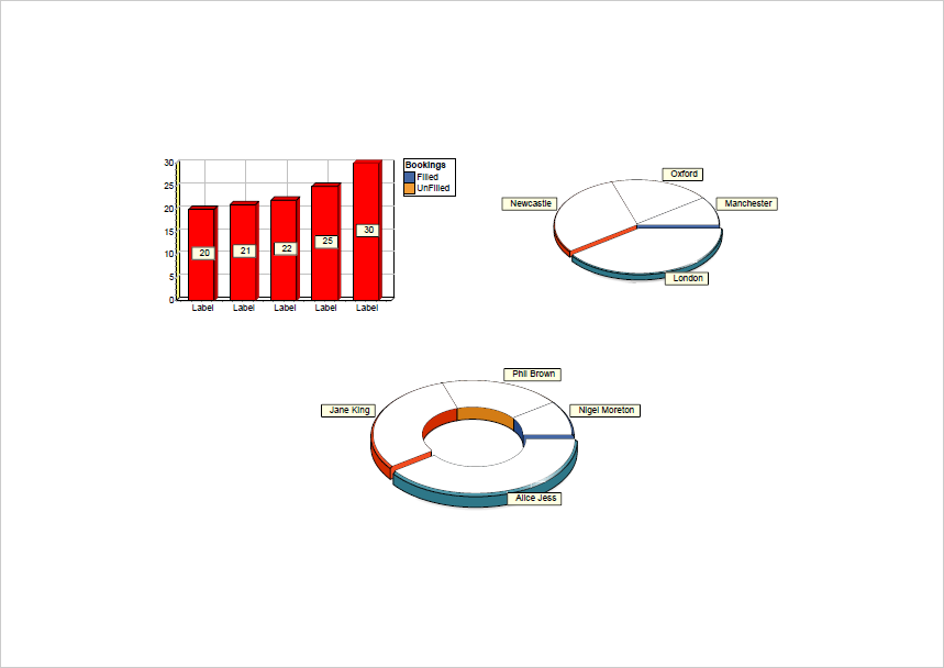

Using a virtual pdf printer I get this result with TeeChart v2016.18 that seems to be what you are reporting:
However, with the current sources I get this:
Which is not perfect because the gradients aren't supported in the export to pdf, but it works much better.
So the next maintenance release should fix this issue.

Thank you - the dashboard charts now print correctly BUT there are no titles either for the charts or the dashboard.
Re: Dashboard not printing correctly.
Post by Yeray » Thu Aug 25, 2016 10:43 am
I see your titles use a white font. Note the printing routine sets a white background. So try changing your font color.
