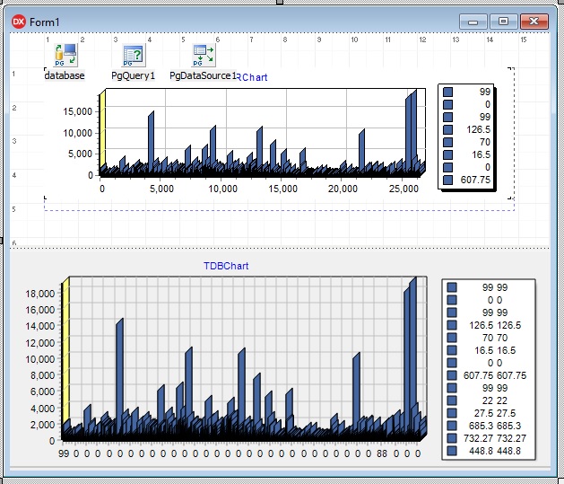

I made a quick project and find that as per attachment that i can get it to display data in both a standard DBChart and a Quick report during design.
It will compile but when it goes to run the app it loads till it reaches the creation point for the form. It will run ok if i remove the series from Quick report and then the standard db will display fine.
- Report Preview.jpg (140 KiB) Viewed 123947 times

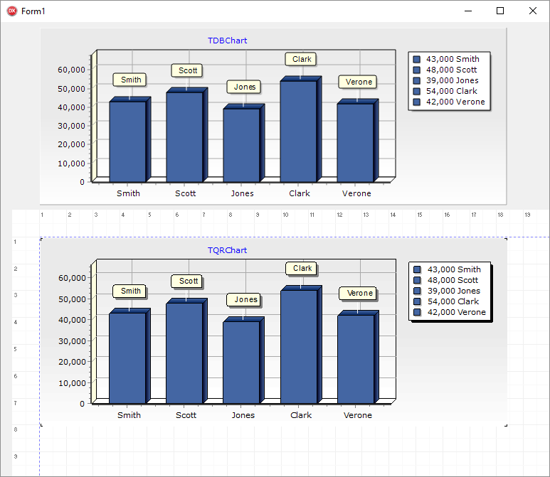

I've done a simple example using a TADOTable and it seems to work fine for me here: Does it work fine for you?

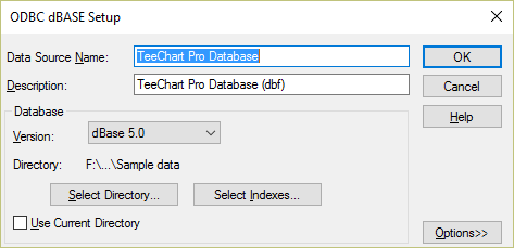

It uses attached database. Which needs to be set like this:

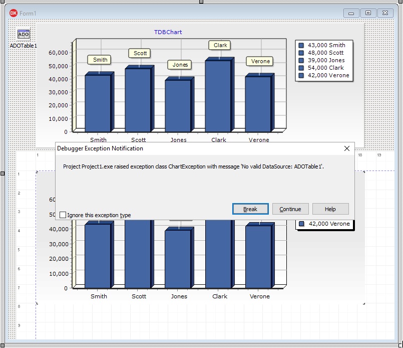

I had hooked it up to a odbc source, error still occurs.
I think you may have missed what i was saying, during design i can live preview the data ok. It will also compile fine. However when the compiled file is run at that point it fails.
The sample odbc database is as per image below is viewable during design, but not when it runs live.

Re: QRTeeChart - Missing Datasource. Quick Report 5 and 2016.18
If you remove the TQuickRep/TQRChart does the error disappear for you?
I can run the project I attached above without errors.Carl wrote:However when the compiled file is run at that point it fails.
