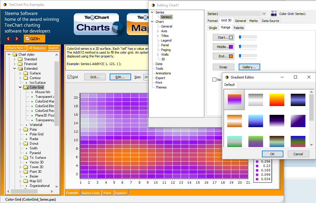

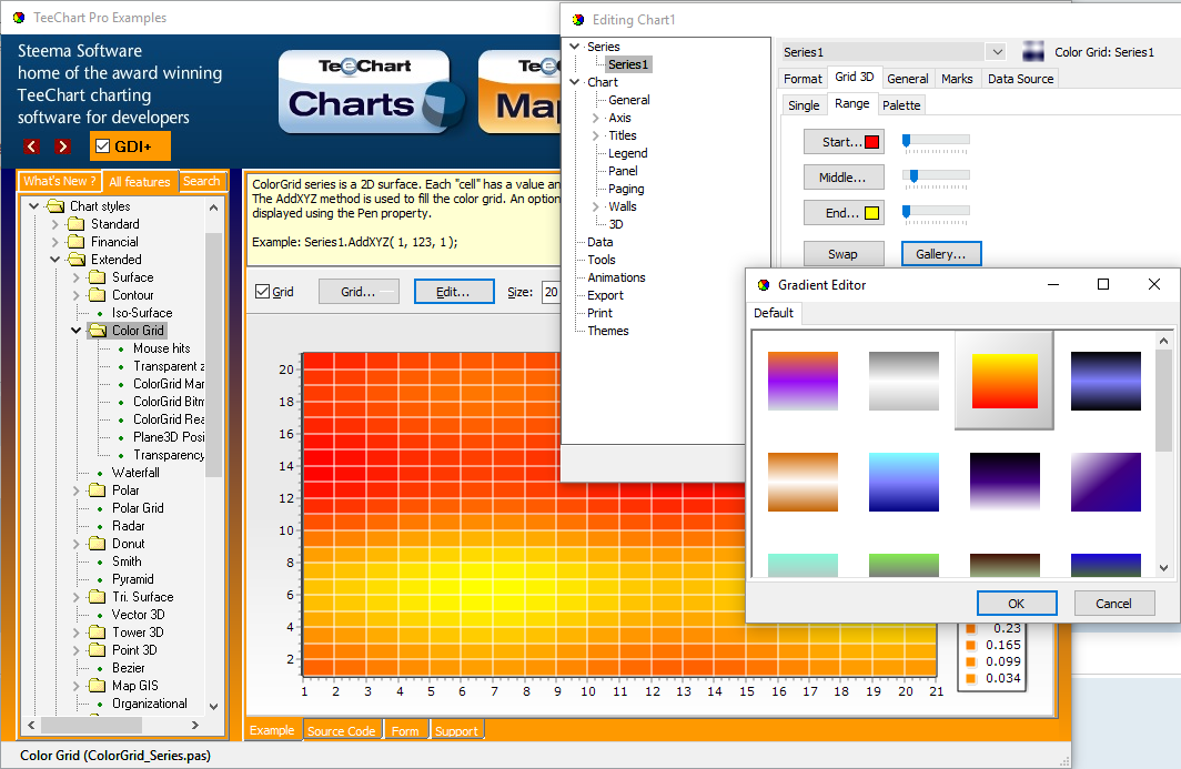

sde wrote: The Range has a "gallery" but when I tried to use that, nothing happened to the colors in the grid
In the ColorGrid example in the Features Demo, if I go to the Range tab, I can change the colors using the gallery. Ie:

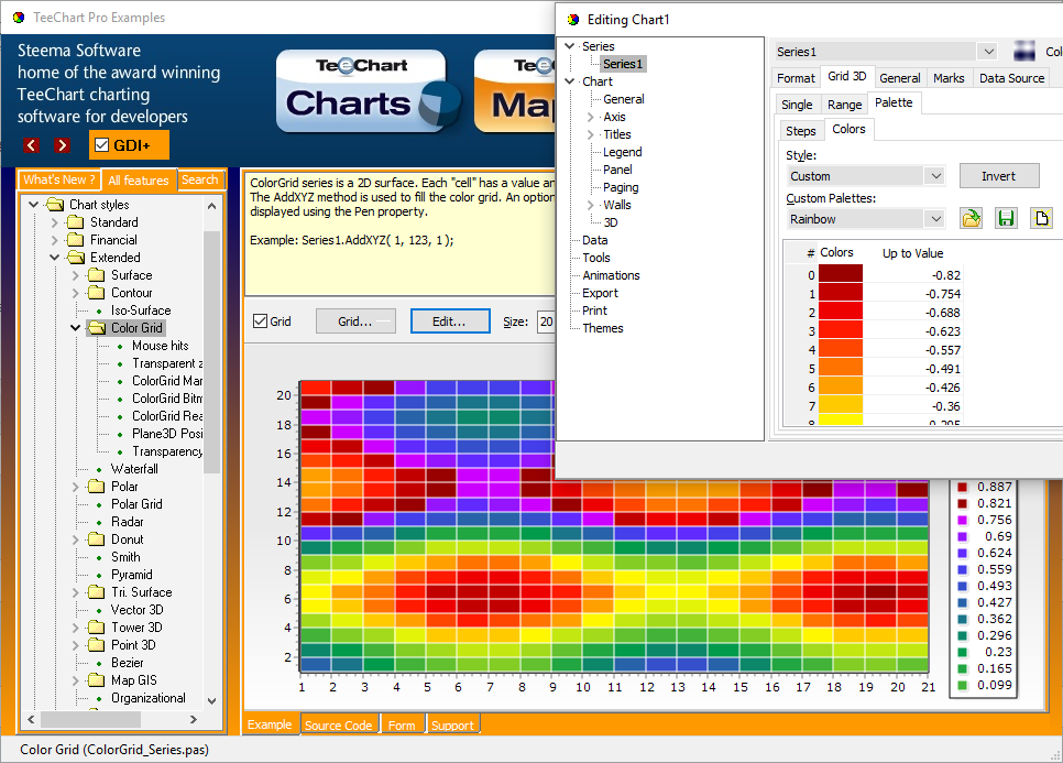

sde wrote: However, if you use a custom palette, the step size does not appear to work.
It seems to work for me. Ie, choosing Rainbow custom palette with the default 32 and 15 steps:

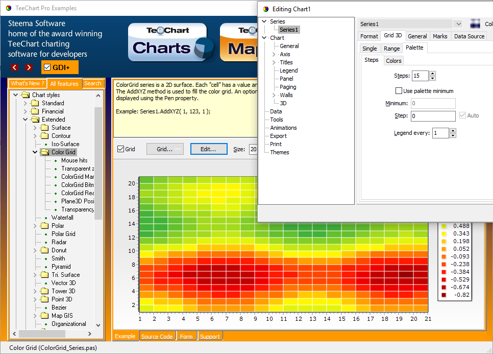

So I was able to recreate my access violation situation. So as soon as you adjust the Legend Every value (Series --> Grid 3D --> Palette --> Steps --> Legend Every speed edit) in the TChart Editor, you get an access violation after which nothing else works or you get more access violations. I also received an access violation when I tried to set TColorGrid(Series1).LegendEvery in my code. Can you please see if you can duplicate?

sde wrote:So as soon as you adjust the Legend Every value (Series --> Grid 3D --> Palette --> Steps --> Legend Every speed edit) in the TChart Editor, you get an access violation after which nothing else works or you get more access violations.
I've been able to reproduce the problem so I've created a ticket on the public tracker:
http://bugs.teechart.net/show_bug.cgi?id=1506
