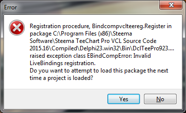

Since version Pro2014 with source I am having troubles installing packages into IDE using TeeRecompile.exe. It never works for me from the first time. I always have to copy some files and do sime improvisation to make it work somehow. Today I tried to install Steema TeeChart Pro VCL Source Code 2015.16 into Delphi 10 Seattle IDE and same problems as always. I am experiencing problems such as missing entry points in bpls, missing paths.
I am using Teechart for more than 7 years now and last two years I am using Teechart with sources. I never had problems with version without sources but version with sources is just a pain in the ass.
Can you tell me what am I doing wrong and can you please write short manual or tutorial on how to install TeeChart with sources step by step that it will work immediately, please?
I will describe you what I do (My OS: Win7 64bit)
1. I start TeeChartVCLSOURCE-2015.16.exe and install it to C:\Program Files (x86)\Steema Software\Steema TeeChart Pro VCL Source Code 2015.16
2. I run TeeRecompile.exe with administrator rights.
3. For the TeechartSource Code folder I usually leave: Source
4. For the Relative Destination: I usually change that to absolute path : C:\Program Files (x86)\Steema Software\Steema TeeChart Pro VCL Source Code 2015.16\Compiled
5. Copy binary files to: C:\Program Files (x86)\Steema Software\Steema TeeChart Pro VCL Source Code 2015.16\Binary
6. I check to install it into RX10 Seattle and click Begin.
The process installs everything without problems. Then I run Delph and I am experiencing error dialog: Can't Load Package " C:\Program Files (x86)\Steema Software\Steema TeeChart Pro VCL Source Code 2015.16\Compiled\Delphi23.win32\Bin\DclTeePro923....%1 is not a valid program Win32.
And this is always with any version of delphi since version XE6. I don't have a right solution for that. Sometimes I copy bpl files to system32 or syswow64 but I am just guessing and I have luck that it starts working... but this is not really a good solution I guess. I always spent too much time dealing with that issues.
Please help me resolve that once for good!

Just one note about how I manually "force" it to work. I actually copy all 32bit bpls to SysWow64 and all 64bit bpls to System32. I have to do that manually everytime.
Re: Installing TeeChart PRO VCL Source issues
I attached image of error I am getting when I run DX10.
- dx10 problems
- teechart.png (39.08 KiB) Viewed 30846 times

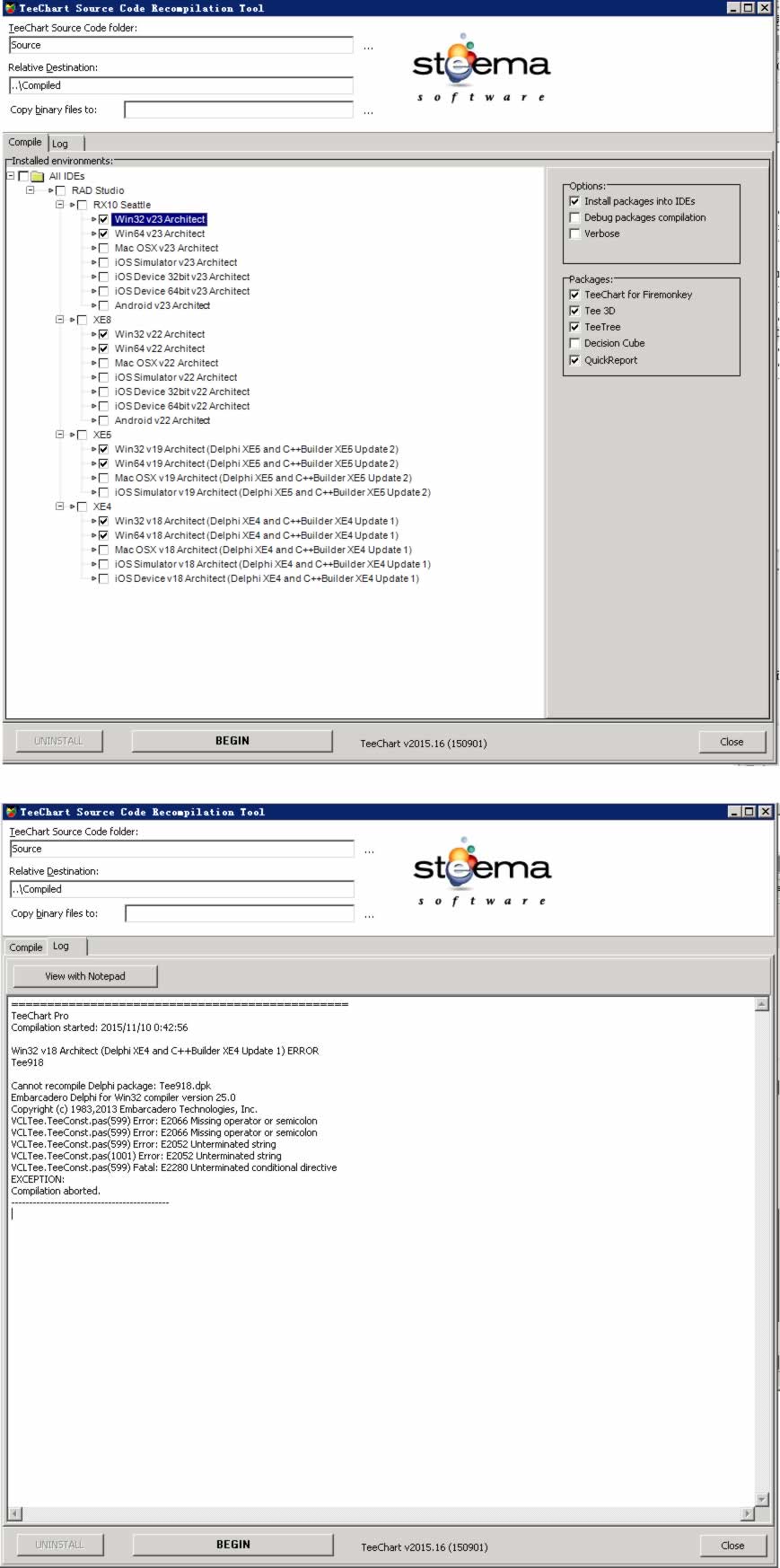

I have same problem in install TeeChart PRO VCL Source code,
OS: Windows server 2008, 64bit
IDE: Delphi XE8 ( I had try in XE4、XE5、XE8、XE10, ALL IDEs cannot install correct.)
Install file: TeeChartVCLSOURCE-2015.16.150901.exe
My install steps:
1. Uninstall old packages of teechart:
1) TeeChart Lite FMX Components
2) TeeChart Standard VCL Components
2. Run setup file to install source code: TeeChartVCLSOURCE-2015.16.150901.exe
3. Setup library paths, x32 and x64.
4. Run TeeRecompile.exe
5. Choose IDEs without mobile dev.
6. Click BEGIN
7. Always error with:
TeeChart Pro
Compilation started: 2015/11/10 0:50:29
Win32 v22 Architect ERROR
Tee922
Cannot recompile Delphi package: Tee922.dpk
Embarcadero Delphi for Win32 compiler version 29.0
Copyright (c) 1983,2015 Embarcadero Technologies, Inc.
VCLTee.TeeConst.pas(599) Error: E2066 Missing operator or semicolon
VCLTee.TeeConst.pas(599) Error: E2052 Unterminated string
VCLTee.TeeConst.pas(1001) Error: E2052 Unterminated string
VCLTee.TeeConst.pas(599) Fatal: E2280 Unterminated conditional directive
EXCEPTION:
Compilation aborted.
I reinstall it, but can not find out the "VCLTee.TeeConst.pas" file in the setup path.
1. I reinstall it, cannot find the file "VCLTee.TeeConst.pas"
2. I found the file "VCLTee.TeeConst.pas" after run TeeRecompile.exe and get "Compilation aborted" message.
3. I checked file "VCLTee.TeeConst.pas",
Line 599 is : TeeMsg_Copyright :={$IFDEF LCL}'(C)'{$ELSE}'?{$ENDIF}+' 1995-2015 by Steema Software';
Line 1001 is: TeePolarDegreeSymbol :='?;
Why?
Note TeeRecompile takes the non-prefixed sources and creates the prefixed versions in the first stage; and puts them into VCL/FMX folders.
I see in your screenshot you are selecting several IDEs at the same time: RAD 10 Seattle, RAD XE8, etc. And it fails with that error when compiling for RAD XE8, so it has finished for RAD 10 Seattle. But I guess the file got corrupted between compiling for RAD 10 Seattle and for RAD XE8.
So I'd suggest you to do each compilation separately; and restore the original TeeConst file you backed up before each compilation; this is the file from the Sources folder, not the files with prefixes.
