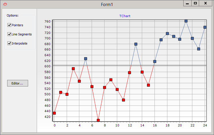

I'm calculating the interpolation XValues (interpPoints) for a given YValue (determined by the colorLine) and adding them to a secondary series (interpLine). Then, maintaining this series I can hide the original series (sourceLine).
This is how it looks:

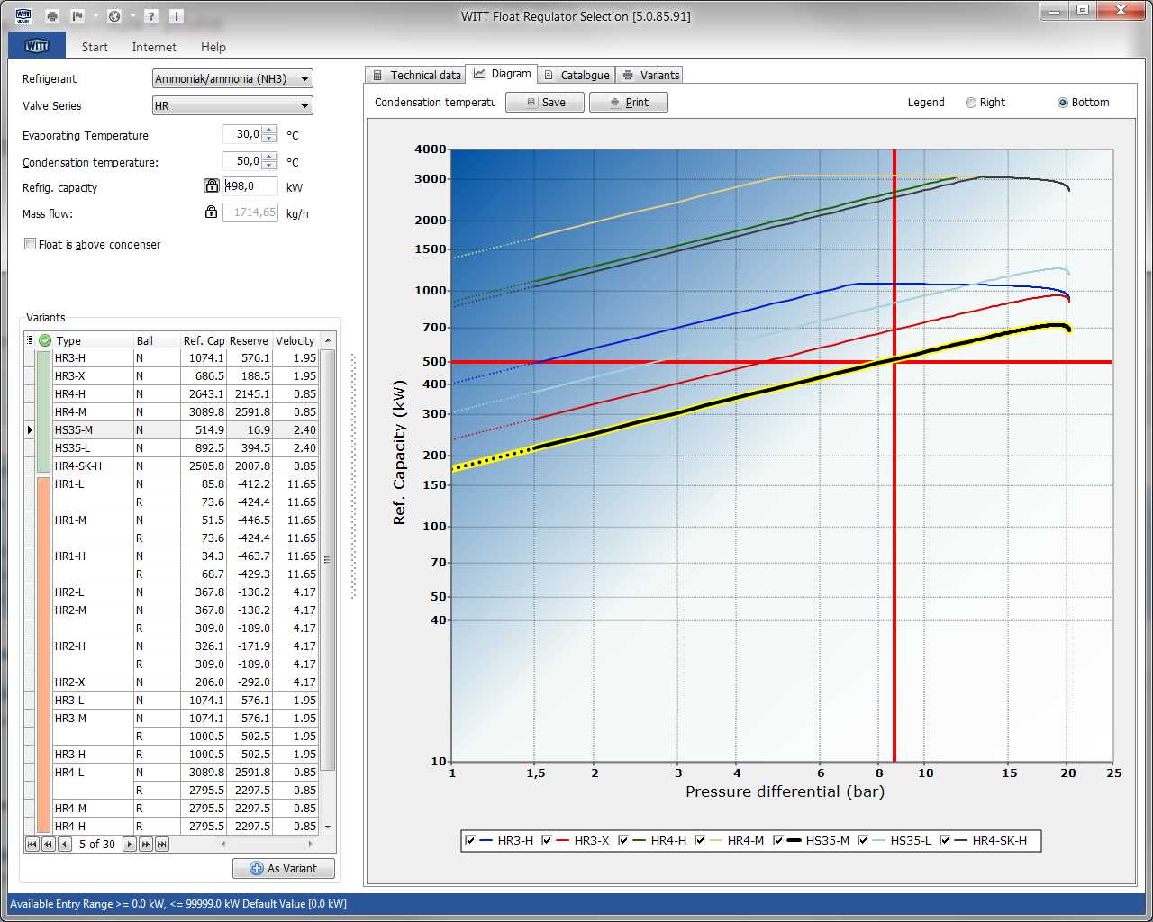

This works, but there seems to be a refresh problem. It is drawn correctly the first time, but if you move the mouse cursor over the diagram window the 'dotted' style disappears.
I attached two screenshots to illustrate that.
I am using the latest version of TeeChart 2015 Pro for VCL.
Screenshot after mouse after window
Screenshot before mouse over window

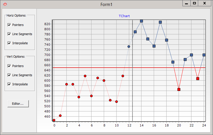

I've modified the example to also implement what I tried to explain in the last post. So now the example includes two ColorLines, an horizontal and a vertical. The horizontal line does the same than before: the points/line segments below the colorline are drawn in red.
The vertical line does what I understand you are trying to achieve: the points/line segments on the left of the colorline are drawn using a circle pointer and dashed line.
testInterpolation.zip
(3.69 KiB) Downloaded 751 times
It seems to work fine for me here, and I can move the mouse around the chart without missing any of the features:
