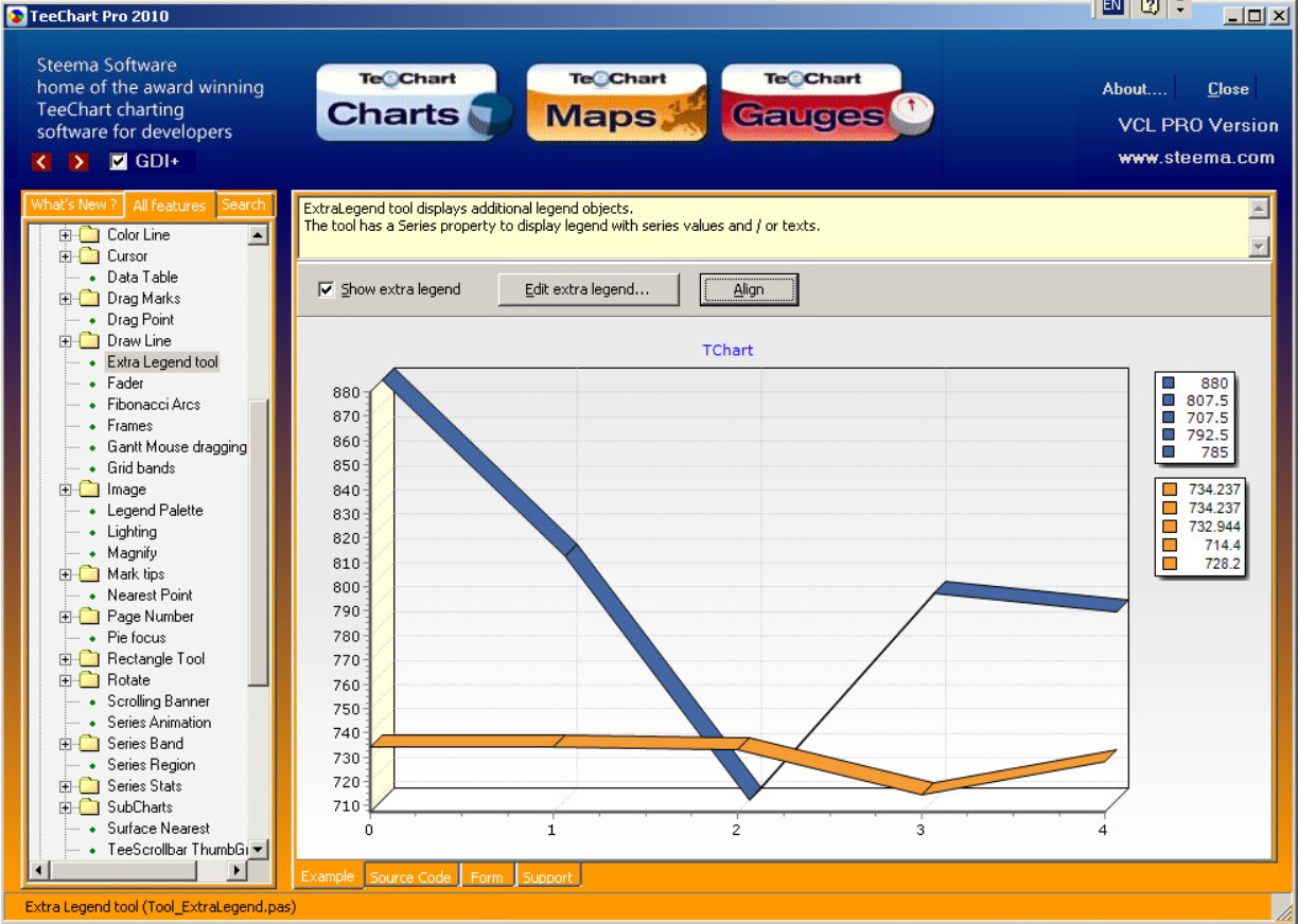

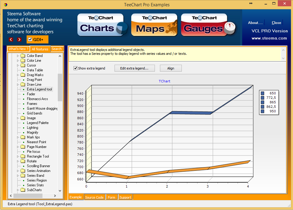

I've been unable to use the TExtraLegendTool recently, regardless of the legend options, the extra legend does not show anywhere on the chart.
After a while, i've realised that the TeeChart Pro demo 2014 exhibits the same behavior.
I might be mistaken, but it looks like a regression no ?
See attached screenshots.
Don't hesitate to contact me for further information,
(Note : i've source code access, if the fix is simple enough, i'll be really interested in a patch to fix this)
Thanks in advance for your help,
current behavior
Expected behavior

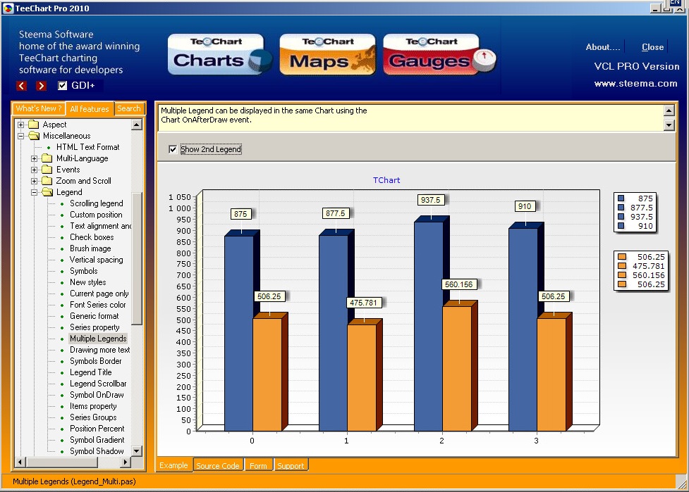

current behavior
expected behavior

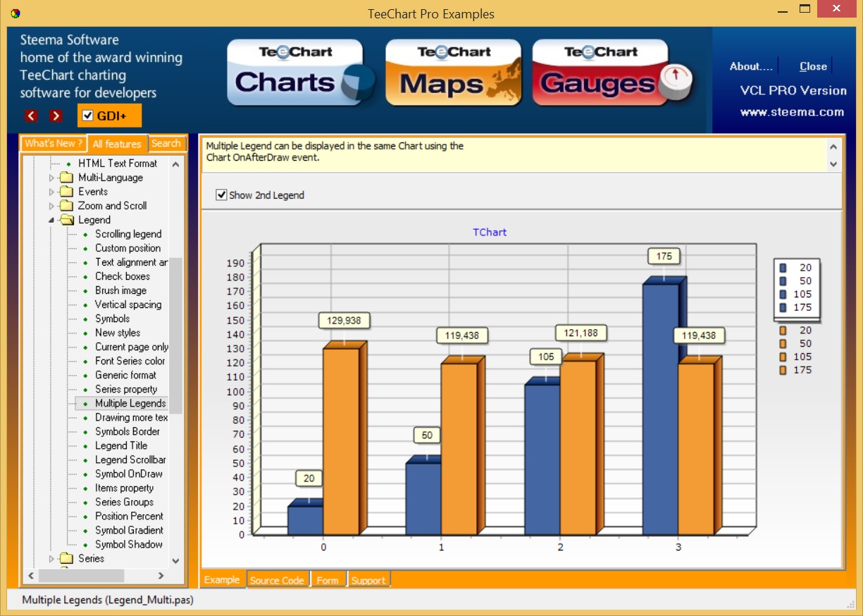

On a side (and probably unrelated note), there seems to be a slight glitch in the legend-canvas drawing stuff
in the latest demo of Multiple Legend in the demo of Tee9New_win32.exe
(GDI+ selection/deselection does not impact the resulting output)
Bottom line is, getting multiple legend is a tricky business in version 2014.10.140220 (VCL)

dsn wrote:On a side (and probably unrelated note), there seems to be a slight glitch in the legend-canvas drawing stuff
I've also reproduced this and added it to the public tracker:
http://bugs.teechart.net/show_bug.cgi?id=756
dsn wrote:Bottom line is, getting multiple legend is a tricky business in version 2014.10.140220 (VCL)
As you'll see, I've found a possible fix for the second. Feel free to implement the change in your sources.
