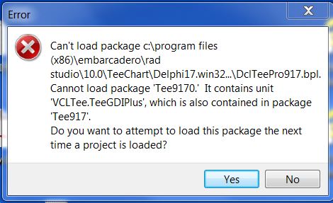

after installing the latest version on Delphi Pro XE,
i start Delphi and i get the message
what to do now ?
