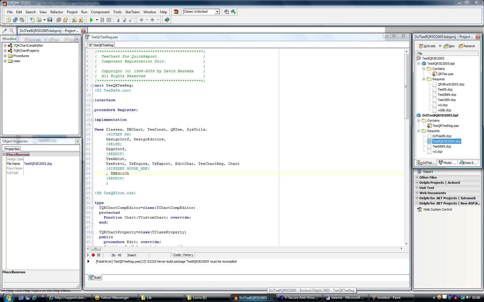

I try to install Teechart 8 on delphi 2005 with quickreport 5 installed. I follow all the steps descriebed in the install and in the articles on this site. It all worked fine until recompiling design time units when i receive an error in teeqrteereg.pas. I attached a picture with the error. Please send me the files for the my combination of delphi, teechart and quickreport 5. I have standard version of teechart 8.

Hi CARCOMPLEXCFR,
Find attached the compiled files and the sources for TQRChart in the environment you are working with.
Please, follow the same instructions in the QuickReport article here to place the files in the according locations.
