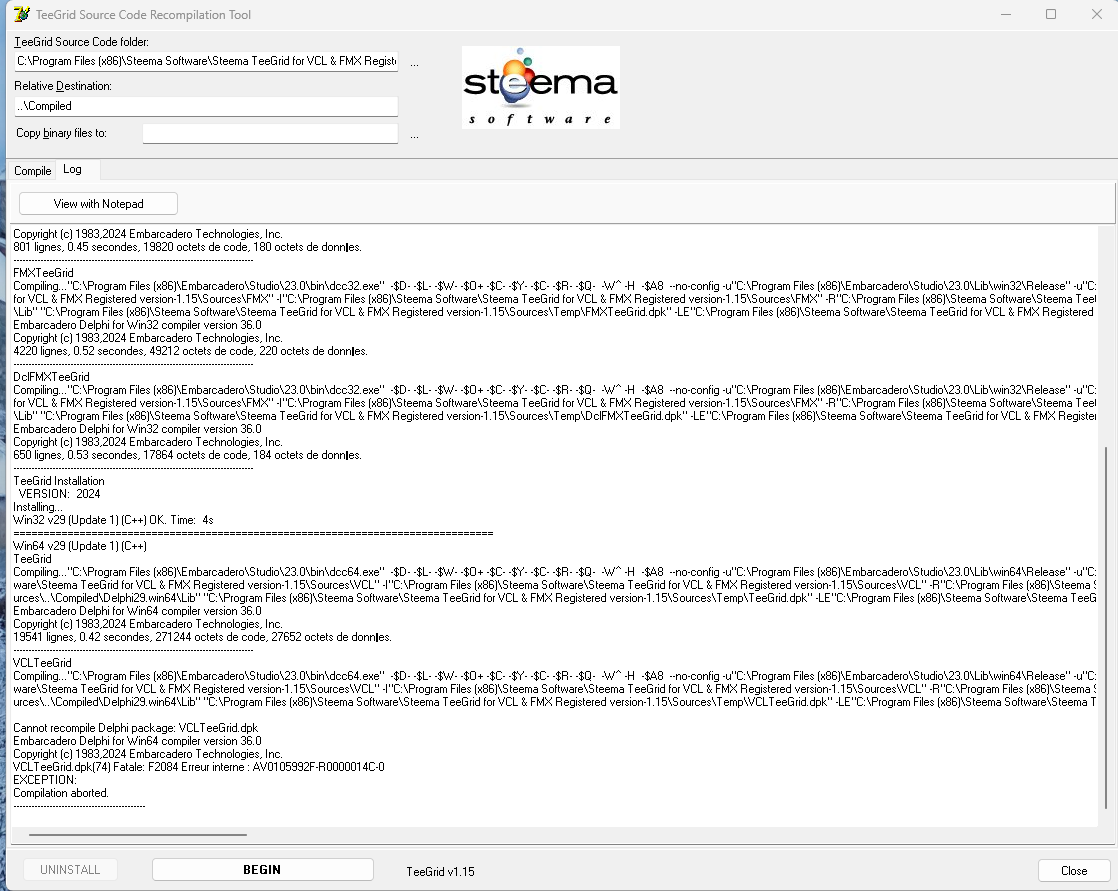

During 64bit compilation, execution stops with the following message:
Win64 v29 (Delphi 12 and C++Builder 12 Update 1) (C++)
TeeGrid
Embarcadero Delphi for Win64 compiler version 36.0
Copyright (c) 1983,2024 Embarcadero Technologies, Inc.
18932 lignes, 0.39 secondes, 264076 octets de code, 26596 octets de donn‚es.
VCLTeeGrid
Cannot recompile Delphi package: VCLTeeGrid.dpk
VCLTeeGrid.dpk(74) Fatale: F2084 Erreur interne : AV0105992F-R0000014C-0
EXCEPTION:
Compilation aborted.
Do you have a solution?

- TeeGrid Source Code Recompilation Log.png (97.62 KiB) Viewed 51740 times

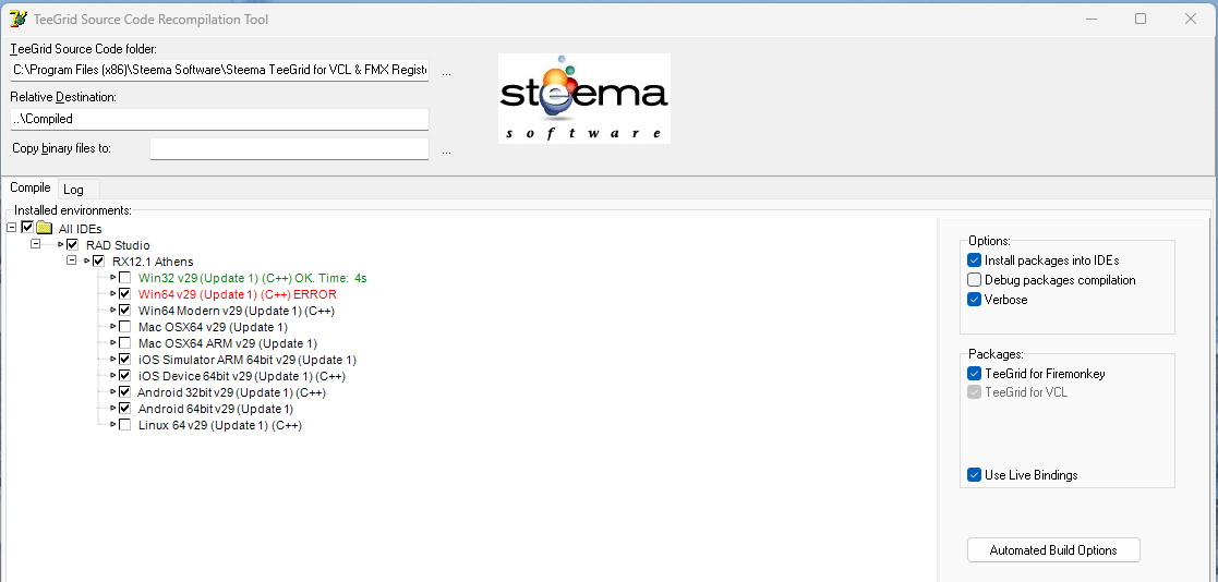

- TeeGrid Source Code Recompilation Tool .png (53.01 KiB) Viewed 51740 times

I've just tried a compile of TeeGrid v1.15 for Win32 and Win64 for Athens 12 update 1. Both compilations ran ok so we know that the basics are ok. The error message on the log output you've sent doesn't seem to offer up any clues.
The compilation writes to the Compiled and Temp folders (under Sources). It may be worth deleting all of the generated folders to check that there's no invalid lock on a file. Then just selecting the Win64 build for a test compilation.

Hello and thank you for your answer.
I followed your advice, but the result is the same.
Oddly, the 64-bit Android compilation works without any problem.
When I look in the 'Compiled' folder I find two subfolders 'Delphi29.win64' and 'Delphi29.win64x' which themselves contain the 'Include, Lib and System' folders which contain the compiled files.
Is this enough for this to work or do we need to add a link in RAD Studio.
THANKS.

I am attaching, by chance, the Log file of my installation which ends with an internal error which will perhaps make sense to you.

The only thing that comes to mind here is a problem with the first RAD Studio 12.1 release that was fixed by a patch from Embarcadero, we had problems compiling the x64 version until the patch was made available. The error message was very similar to the one you report. It looks like you're on the same RAD Studio version that I'm testing here so that shouldn't be the cause of the problem, but just in case, here's the build number we are running:
RAD Studio Version 29.0.51961.7529.
The Embarcadero patch announcement:
https://blogs.embarcadero.com/rad-studi ... available/
Re: Installing TeeGrid 1.15
I had the same install problem (using 29.0.51961.7529).
I tried to use the source files but I get compilation error related to undefined constants (SB_HORZ and all his friends).
I finally rerun TeeGridRecompile.exe and it finished with succes. I can now compile x64, but I get flicker problems (see my recent post).
Erik
Erik
