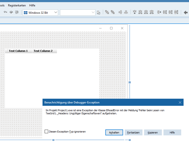

Before any application Window opens, the application throws an exception: "Invalid property value"
First

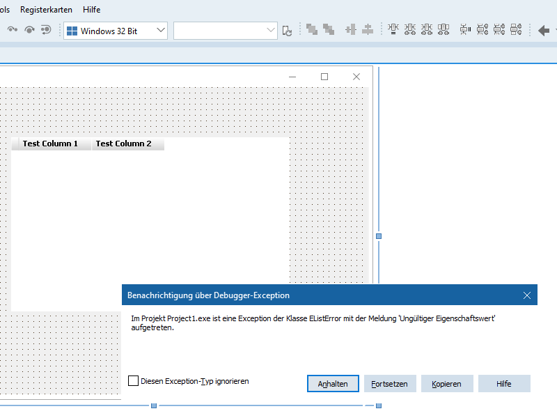

After clicking the button "continue" it shows a 2nd one.

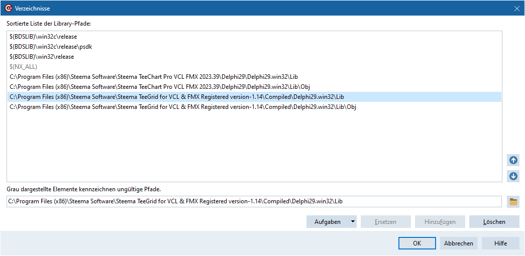

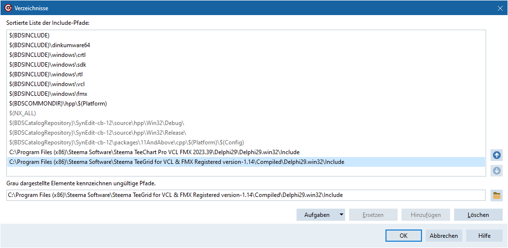

This is the first time ever we're using TeeGrid. There are no other versions in the search path. We do have TeeChart Pro installed, though. But I think this isn't the problem. All the paths have been set up by the installer.
Include-Path:
Library-Path:

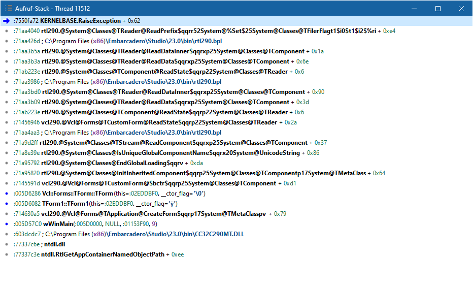

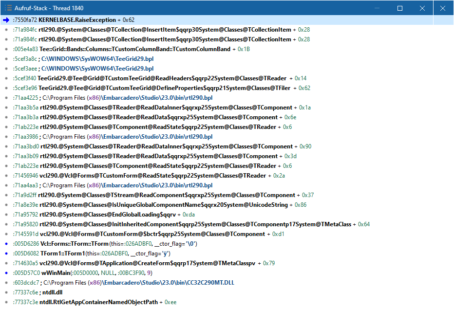

I've attached the two stack traces.
First exception:

Second exception:

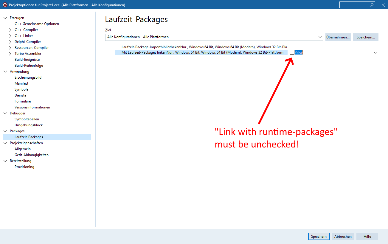

FIXED IT :D
In the project options "Packages" --> "Runtime Packages" one must uncheck "link with runtime-packages".
Can somebody please confirm this?

I just checked that. It runs ok with or without the 'runtime packages' selected. It may be something in the package list on your setup that is causing the problem.
TeeGrid is in the package list on the test installation here.
