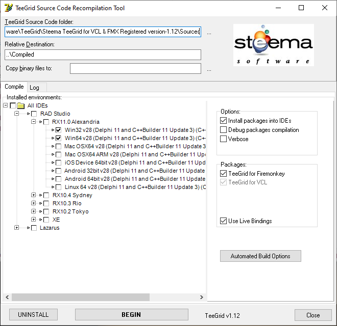

Version 1.12 binary. Only Windows32, Windows64 and Linux64 selected. By the way, I do not have Lazarus in the list of selectable environments and platforms, although I have two versions installed - 32-x and 64-bit

Please, select Win32 and Win64 only in TeeGridRecompile, not Linux.
When it finishes, open the IDE and add the "Sources\FMX" to the "Library path" for the "Linux 64-bit" platform, in a similar way as below:

Thanks, it worked. True, I did not understand what the problem with Linux is - there are all the necessary libraries for it. And the problem with Lazarus remains open - TeeGridRecompile.exe does not see it

Same for us here. We haven't found a way to make the compilation command (which works in the IDE) to work in TeeGridRecompile.
To detect Lazarus, TeeGridRecompile searches for the following key in the registry:
HKEY_CLASSES_ROOT\Lazarus.AssocFile.pp\Shell\Open\Command
Can you please check if you have that key?
