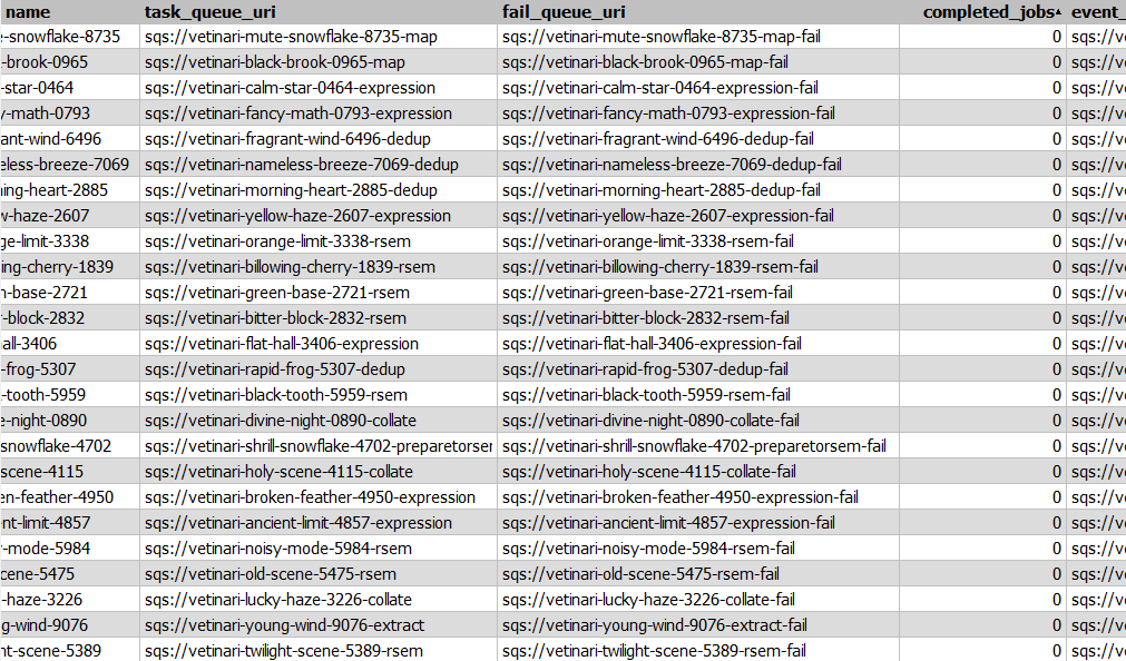

The grid scrolls back back to the left (the sort is being maintained)

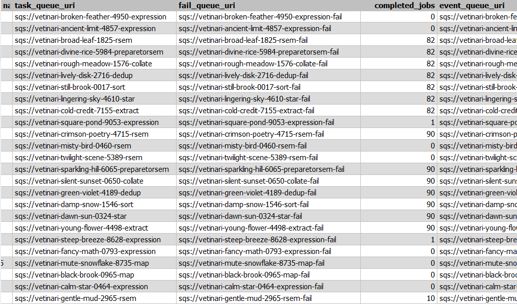

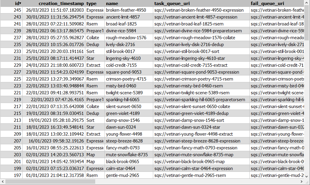

Missing is the first state of the grid:
