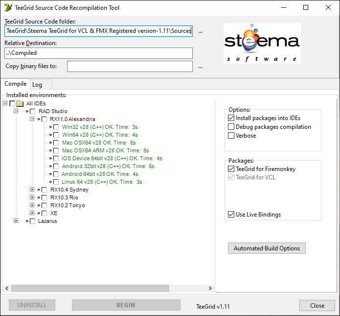

I have installed the Teegrid 1.11 into Delphi 11 but the compiler is showing FMXTee.control not found.
Please help

The compiler is showing FMXTee.Control and FMXTee.Grid not found in building Linux 64 application. Under Windows Apps is no problem.
Re: TeeGrid - Delphi 11
Post by Yeray » Fri Nov 05, 2021 7:55 am
I see TeeGridRecompile builds TeeGrid 1.11 for linux platform in RAD 11 without errors:
But the "Compiled\Delphi28.linux64\Lib" folder doesn't contain any "FMXTee.*" unit. We'll revise it.
In the meanwhile, I've checked adding the "Sources" and "Sources\FMX" folders to the "Library path" for "Linux 64-bit" platform works fine.
I have just had the time to build Linux-64 bit according to your indication. However, this method cannot be worked. It is the same result "Compiled\Delphi28.linux64\lib" folder doesn't contain any "FMXTee.*" unit.
Please help again.

Post by Yeray » Wed Dec 22, 2021 8:48 am
Have you tried adding the "Sources" and "Sources\FMX" folders to the "Library path" for "Linux 64-bit" platform?

Post by laiyukwa » Thu Dec 23, 2021 6:34 am
Have already adding to "Ordered list of Library paths" of Linux 64-bit platform. But no help.
Post by Yeray » Thu Dec 23, 2021 7:32 am
What error are you getting?
