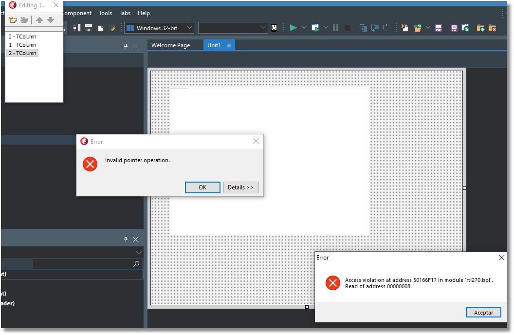

When inserting the teegrid to a form there is no problem, but when creating a new view Ejm: Andrid 10 tablet
and you want to add columns in the master view, there is a general bug and the whole delphi crashes

We should investigate that error.
If I add the columns in the Android view, switch to the master view and then add the columns again, then I see no error. Could you please confirm that?
