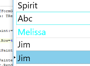

yes now works, but the colors are wrong!
AData.Painter.SetFontColor( TColors.Yellow );
I set Tcolors.yellow ... and I have the color "light blue"
see the attachment
Antonello

Re: Cell custom font color
Post by Yeray » Mon Mar 05, 2018 12:32 pm
Sorry, I was testing it in VCL, not in FMX.
It gives me a light blue when I use TColors.Yellow in Firemonkey, but it gives me yellow when I use TAlphaColors.Yellow.

Post by acarlomagno » Mon Mar 05, 2018 4:32 pm
ok with TAlphacolors.yellow .. it correct
mah ... I am going crazy ;-)
