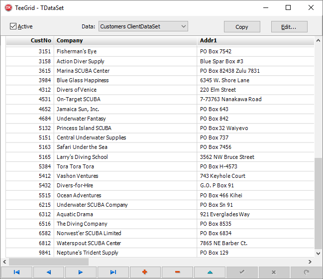

What version are you using? Here, using v1.03 I see the last row and the horizontal scroll bar without problems. Ie, running the example from "demos\VCL\Database\ClientDataSet":

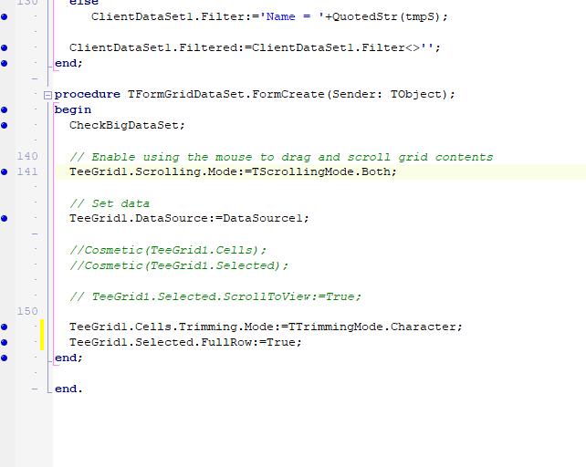

Note I've added a line of code at the end of the FormCreate in that example to select the FullRow:
  TeeGrid1.Selected.FullRow:=True;

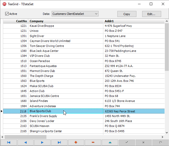

I'm trying to reproduce the problem of the horizontal scroll bar in FMX with the example at "demos\FireMonkey\Database\DataSet" without success. It seems to work fine for me here:
