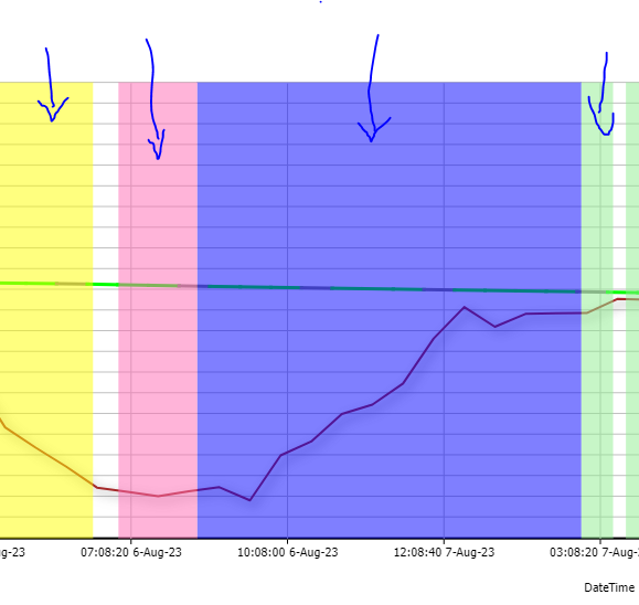

I have been trying to find the click event on the rectangle, how can I detect the rectangle by click event?
click event need

I am using the below
formatBlue: Tee.IFormat;
this.Chart.ondraw = function () {
  for (let i = 0; i < this.data.length; i++) {
    let x1 = this.axes.bottom.calc(startDate);
    let x2 = this.axes.bottom.calc(data[i]);
    let y1 = this.axes.left.startPos;
    let y2 = this.axes.left.endPos;
    this.formatBlue.rectangle(x1, y1, x2 - x1, y2 - y1);
I need every click event for every formatBlue will draw .
