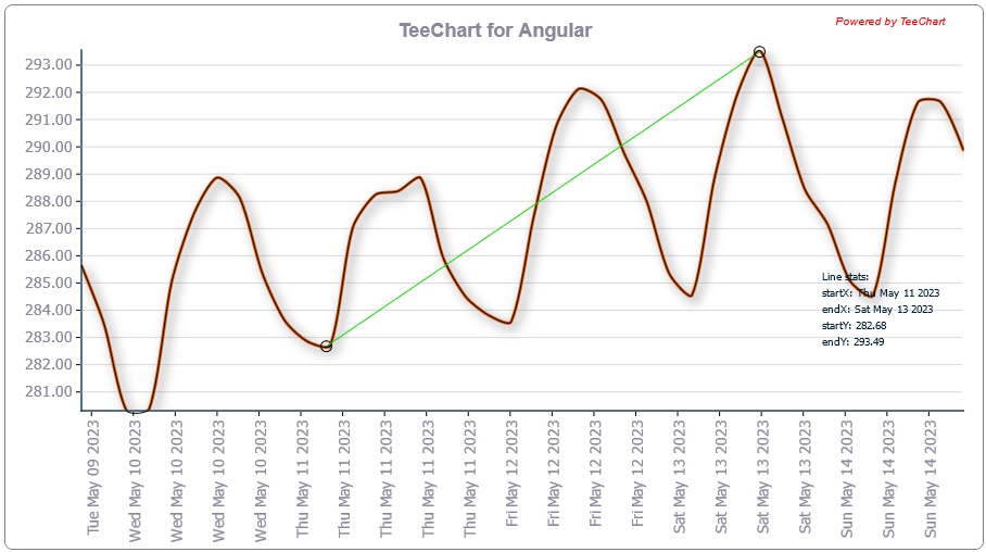

This example (mousedown-drag line draw) includes code that I think is relevant to what you want:
https://www.steema.com/files/public/tee ... /lines.htm
I'll have a look to porting some elements over to the angular example,
Posts: 1299
Re: Tee Chart for Angular & Draw a Painting Manually
Post by Marc » Tue May 09, 2023 3:46 pm
The standard angular example has been modified. The location has changed to:
https://gitlab.com/steema/teechartjs/-/ ... ns/angular
The demo includes code for mouse movement and custom output to the canvas.
