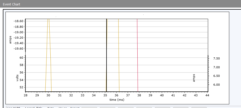

On zoom (horizontal and vertical enabled) and scroll (up and down) the series are not bound to their respective axis and the lines cross over (chart attached).

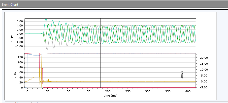

View when zoomed in. The series at the bottom takes the entire chart space
Charts default view
