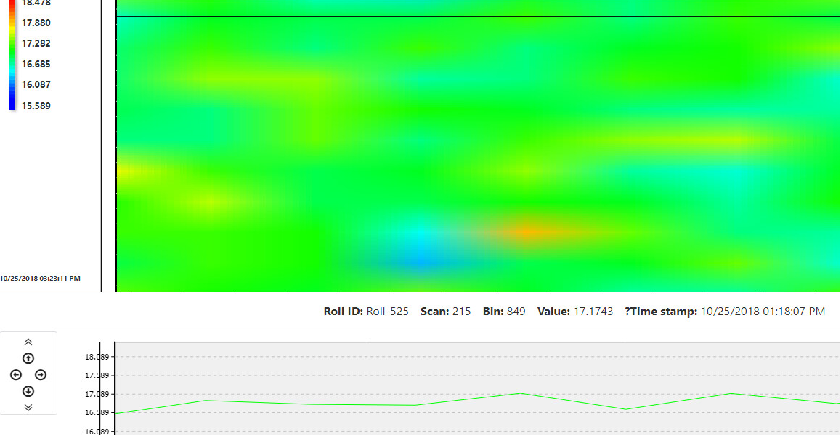

And on hover of MD chart we don't want to see all chart values and just want to see green lines custom info(Means title).

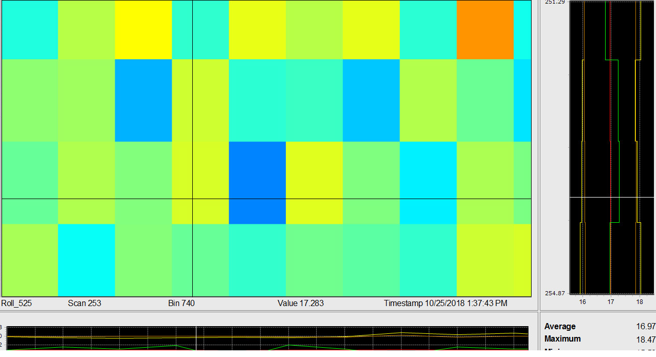

while Zooming how to make this color graph smooth zooming.Attached a screen shot where we are zooming using .net teechart control getting expected result.
teechart JS : on hover of chart getting RangeError: Maximum call stack size exceeded
- steemaJsZoomed.png (291.15 KiB) Viewed 50750 times
- Expected zoom.png (136.16 KiB) Viewed 50750 times
