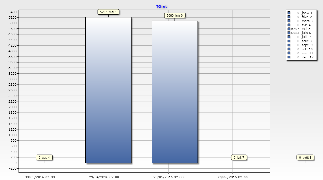

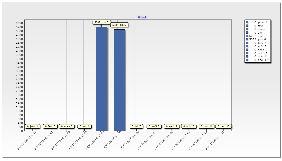

I have problem with graphic with increment month, the date for each bar is not correct.
The increment seems fixed of 30 days.
If I chose automatic increment, it doesn't work anymore.
Problem using increment Month

- LabelBottomAxisIncrementAutomatique.png (16.55 KiB) Viewed 21126 times
- LabelBottomAxisIncrementMonth.png (50.3 KiB) Viewed 21127 times

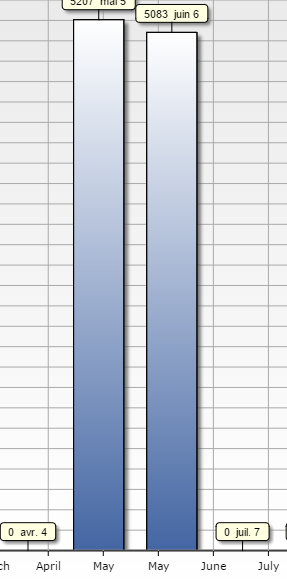

Re: Problem using increment Month
The VCL project you've attached gives me a slightly different Javascript output for me: So I assume you modified it to get that result.
Yes, i've just changed the date format.
