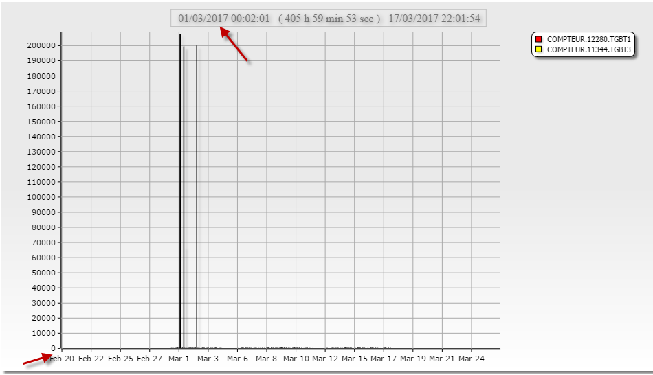

the min and max haven"t good value when a serie is empty.
Min Max Axe X
Min Max Axe X

Re: Min Max Axe X
le graphic should start at Mar 1 instead of Feb 20.
There's no data between Feb 20 and Mar 1
- PbAxes.png (45.39 KiB) Viewed 31624 times

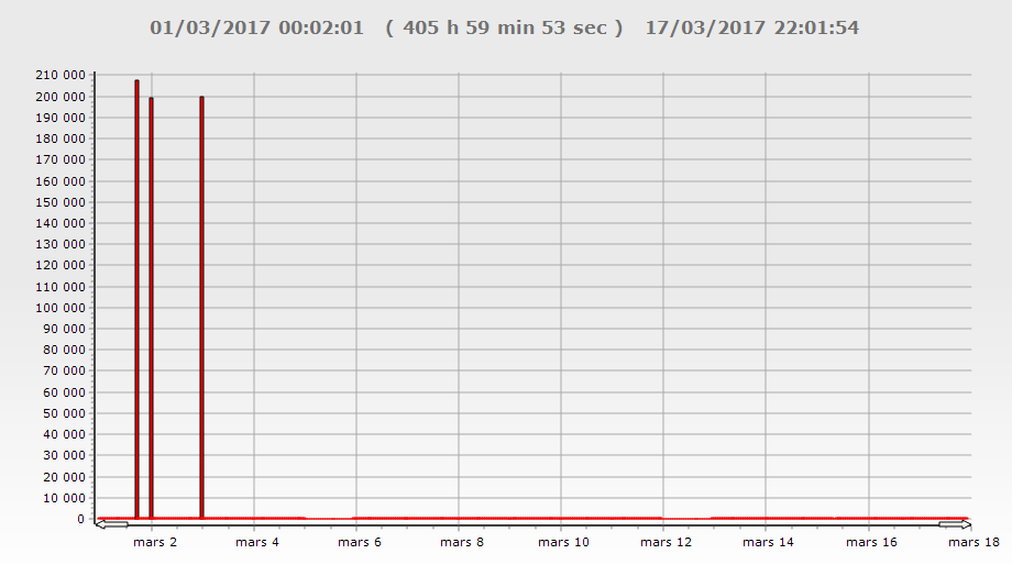

Re: Min Max Axe X
I should have the same bottom axe value of the vlc graph.
- Graphe VCL.png (17.12 KiB) Viewed 31609 times
Re: Min Max Axe X
I could reproduce the problem in a simple example so I've added it to the public tracker:
http://bugs.teechart.net/show_bug.cgi?id=1853
As a workaround you can add this to manually set the axis range:
Chart1.axes.bottom.setMinMax(Series1.minXValue(), Series1.maxXValue());
Re: Min Max Axe X
The problem that causes the offset of the first plotted value in this chart is the presence of a second series that has no values; Series3.
If Series3 code is commented, or not added to the chart (until needed) then the plot is correct.
