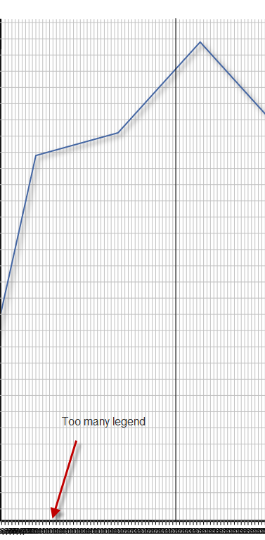

Would-it possible like in vcl chart to limit automaticaly the number of legend displayed?
Re: Export as HTML5 JScript
Post by Yeray » Thu Sep 15, 2016 7:51 am
Menant.D wrote:Would-it possible like in vcl chart to limit automaticaly the number of legend displayed?
This seems to be the bottom axis labels, not the legend.
There may be some difference on how both versions handle the increment in the axis. Could you please arrange a simple example project we can run as-is to reproduce the problem here?

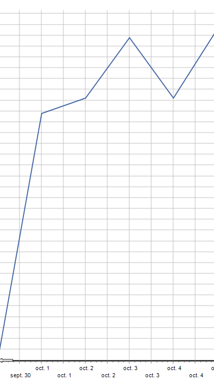

You're right, it concern labels of bottom Axe.
The difference is where we put an increment(one day for example) in automatic increment.
You can see it in the project join.

Post by Yeray » Fri Sep 16, 2016 8:55 am
This is because the increment property in TeeChart HTML5 is a bit different than in TeeChart VCL.
http://bugs.teechart.net/show_bug.cgi?id=1632
