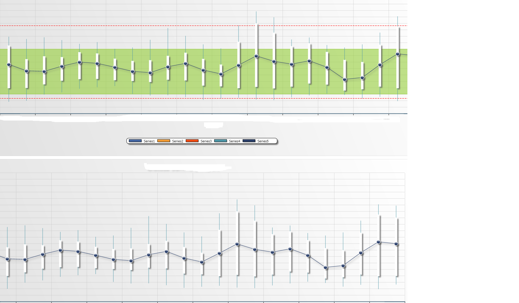

Post by SenSeo » Tue May 03, 2016 11:28 am
I used the below line to save generated chart to image. I was able to generate a chart success, but applied background color and format is not displayed with series in the image. Please refer the attached screenshot.
 Chart1.toImage('pngimage', 'image/png');

Does it require to write additional code to bring the background color and format of the chart to an image?

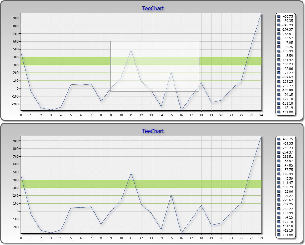

Post by Yeray » Wed May 04, 2016 7:40 am
I've done a simple example with just a Tee.Line series and the javascript chart looks the same than the png image:
Note I've drawn a zoom rectangle with the mouse in the javascript chart to see a difference with the png image chart.
