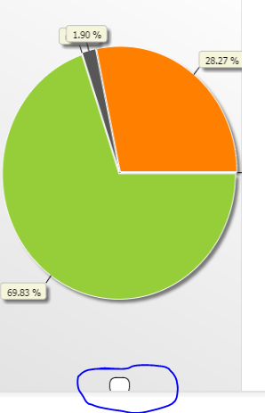

The legend is not resized along with the canvas when we access the chart for mobile devices. Below function is used to resize the chart and legend.

Is there any way to fix the legend issue for a mobile device?
Resize issue
Lengend_resize issue.PNG (29.16 KiB) Viewed 8831 times
