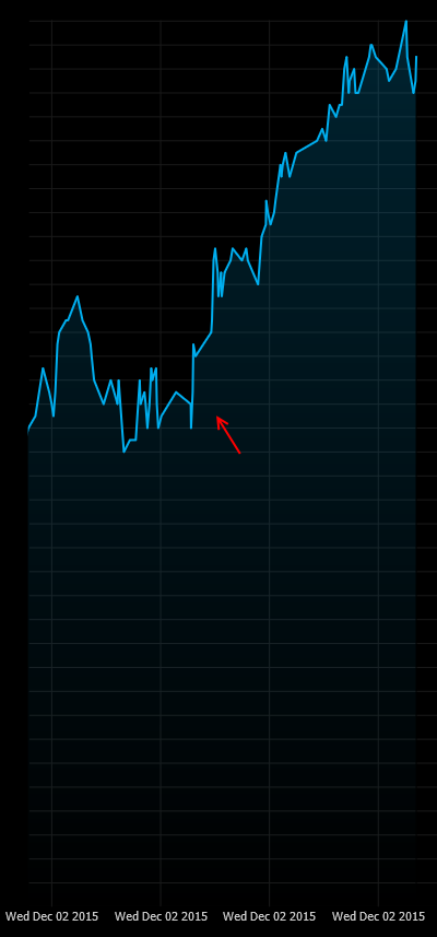

Hi guys,

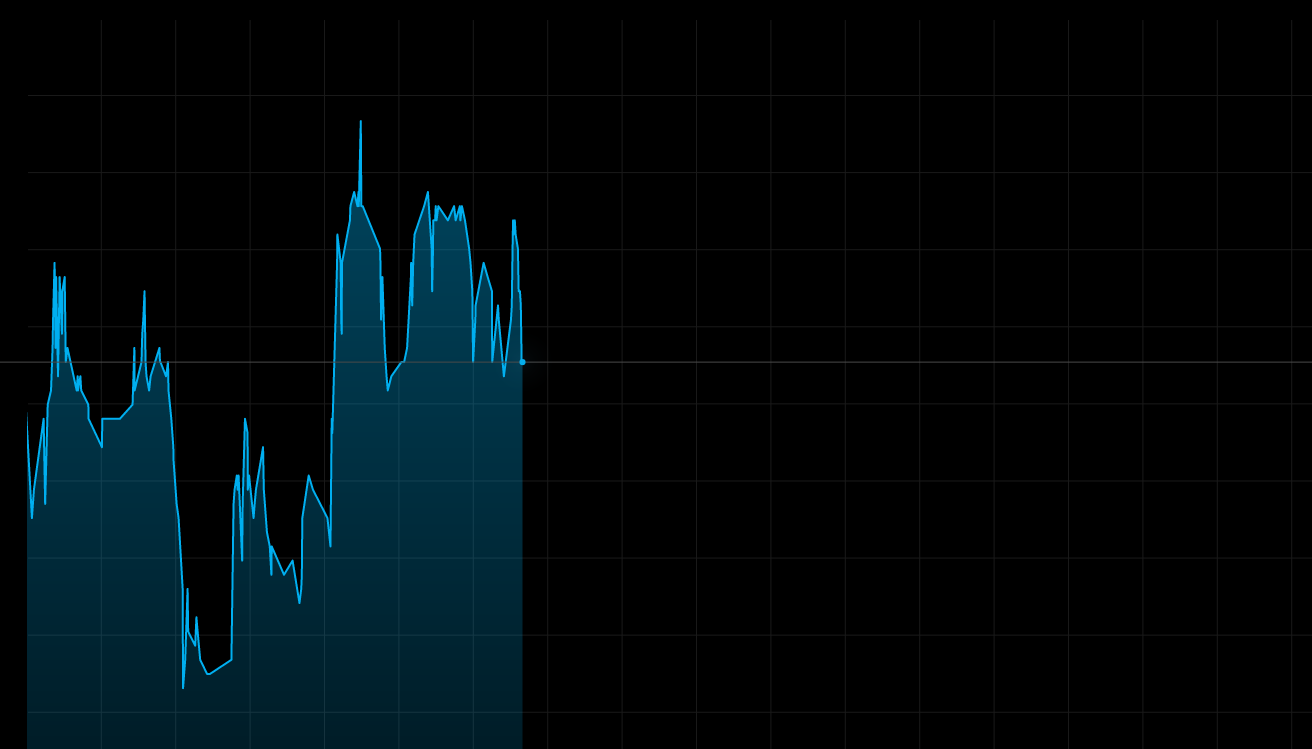

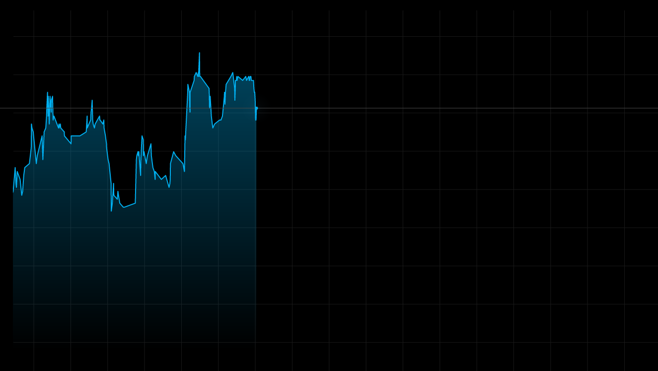

We need from your help. We are using an area chart with gradient. After changing min/max on right axis gradient doesn't keep the original color. Is it possible to fix that? Thanks in advance.
Example page is here: http://en.1009.binarate.com/prosite/teechart ( here depend of dynamic prices and I'm not sure will see the bug ).
Code example:
function yz() {
            var l = sd[sd.length - 1][1],
             h = 0;
            for (var i = sd.length - 1; i >= 0; i--) {
                var dc = sd[i],
                    dcox =Chart1.axes.bottom.calc(dc[0])
                if (dcox > 0 && dc[1] > h) {
                    h = dc[1];
                if (dcox > 0 && dc[1] < l) {
                    l = dc[1];
                if (dcox < 0)
                    break;
            Chart1.axes.right.setMinMax(l * 0.99990, h * 1.00010),
            Chart1.axes.right.increment = (Chart1.axes.right.maximum - Chart1.axes.right.minimum) / 10;
Screencasts attached here below:
After changing
regular one

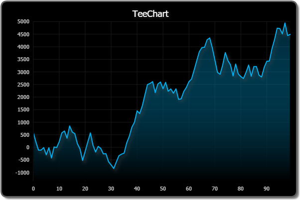

This is how it looks:
Note I've used useOrigin and origin properties to set the bottom of the gradient.

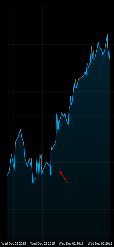

I've made 2 screenshots, one before and anotherone after the axis rescale.
Using a simple drawing program (ie Paint.NET) I capture the color of a pixel from each screenshot, both corresponding to the same zone, and I get the same value. In the point I highlighted in both screenshots I'm getting RGB=(0, 19, 27):
before
after
So it seems to me that the gradient is kept after changing the axis scale.

in your an example you can also see the difference with the gradient color before and after changing the scale. You can take a look carefully and will see it that blue color should finish to full transparency.
I understood the gradient should be drawn only to the visible part of chart area and then should keep start/to color and their transparencies always. I'll try to fix it.
Thanks guys.

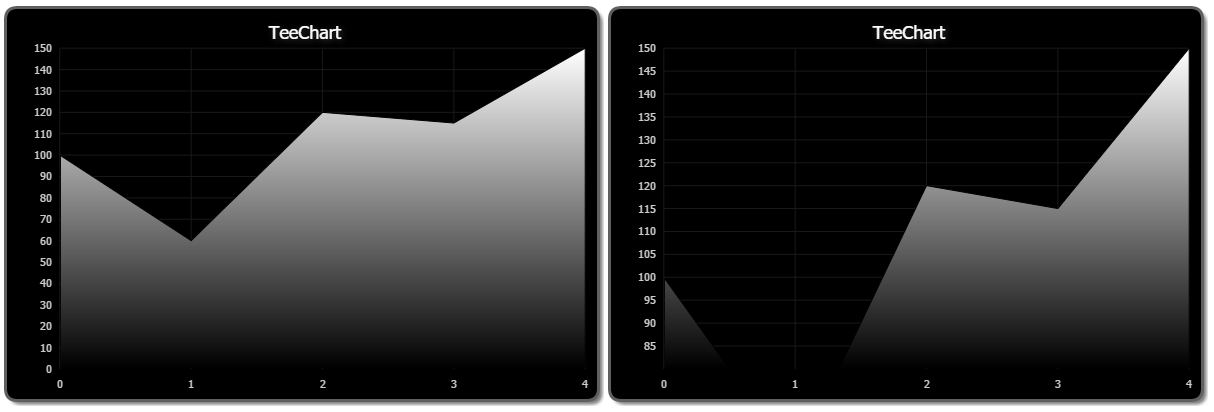

Hello, again

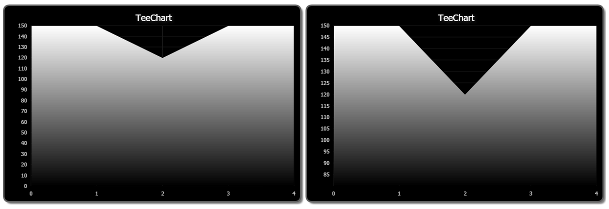

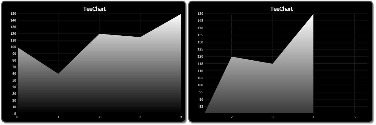

Thanks for the example page. I just changed the example and scrolled to the left side
<!DOCTYPE html>
<html>
<head>
<title>Testing</title>
<script src="teechart.js" type="text/javascript"></script>
<script src="date.format.js" type="text/javascript"></script>
        var Chart1, Chart2;
        function draw() {
            Chart2 = new Tee.Chart("canvas2");
            createArea(Chart1);
            createArea(Chart2);
            Chart1.axes.left.setMinMax(0, 150);
            area1 = Chart1.series.items[0];
            area1.useOrigin = true;
            area1.origin = Chart1.axes.left.minimum;
            Chart2.axes.left.setMinMax(80, 150);
            area2 = Chart2.series.items[0];
            area2.useOrigin = true;
            area2.origin = Chart2.axes.left.minimum;
            Chart1.draw();
            Chart2.draw();
        function createArea(chart) {
            chart.title.format.font.fill = "white";
            chart.legend.visible = false;
            chart.panel.format.gradient.visible = false;
            chart.panel.format.fill = "black";
            chart.walls.visible = false;
            chart.axes.bottom.grid.format.stroke.fill = "#191919";
            chart.axes.left.grid.format.stroke.fill = "#191919";
            chart.axes.bottom.labels.format.font.fill = "#ccc";
            chart.axes.left.labels.format.font.fill = "#ccc";
            chart.scroll.enabled = true;
            chart.scroll.mouseButton = 0;
            chart.scroll.direction = "horizontal";
            var area = new Tee.Area();
            chart.addSeries(area);
            area.data.values = [100, 60, 120, 115, 150];
            area.format.shadow.visible = false;
            area.format.stroke.visible = false;
            area.format.fill = "black";
            area.format.gradient.visible = true;
            area.format.gradient.colors[0] = "white";
    </script>
</head>
<body onload="draw()">
    <br>
    <center>
    <canvas id="canvas1" width="600" height="400">
    </canvas>
    <canvas id="canvas2" width="600" height="400">
    </canvas>
</center>
    <br>
    <svg id="usa" class="map" width="100%" height="100%" />
</body>
</html>
Re: Area chart gradient bug
Post by Yeray » Wed Dec 09, 2015 2:50 pm
I see the gradient is drawn considering a rectangle with a height calculated taking this minYValue:
  this.minYValue=function() {
    var v=this.yMandatory ? Tee.Series.prototype.minYValue.call(this) : Tee.Series.prototype.minXValue.call(this);
    return this.yMandatory ? this.useOrigin ? Math.min(v,this.origin) : v : v;
In the code you've just posted, the smaller YValue on the series is 60 and origin is 80, so the Math.min(v,this.origin) call above returns 60 and the gradient is calculated considering the bottom of the rectangle at 60.
You can change that overriding the minYValue function for the area2. Ie:
        function draw() {
            area2.minYValue=function() {
            return this.yMandatory ? this.useOrigin ? this.origin : v : v;
            Chart1.draw();
            Chart2.draw();

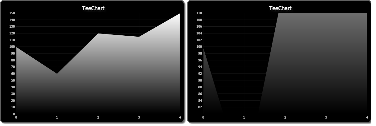

It seems works but in our real situation we change min and max together with a near values.
<!DOCTYPE html>
<html>
<head>
<!--[if lt IE 9]>
    <script src="../src/excanvas/excanvas_text.js"></script>
    <script src="../src/excanvas/canvas.text.js"></script>
<![endif]-->
        var Chart1, Chart2;
        function draw() {
            createArea(Chart1);
            createArea(Chart2);
            Chart2.axes.left.setMinMax(80, 110);
            Chart1.draw();
            Chart2.draw();
    </script>
</head>
    <br>
    <center>
    </canvas>
    </canvas>
</center>
    <br>
</body>
</html>
Could you please give us a solution where the maxY is also included in the calculations if it possible of course.
In all cases we want to keep the gradient perfectly.
