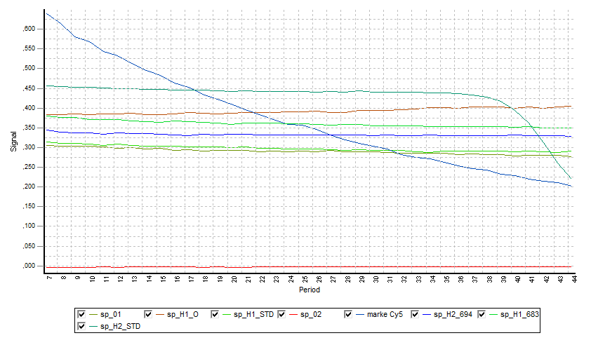

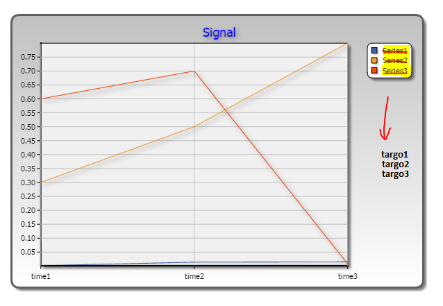

A requirement of our chart component is to have custom labels in the Legend. I have looked at textStyle-possibilities.
Problem 1: The key (targo1, targo2, targo3 /please, see code-example) should appear at each legend item.
Problem 2: I’ve added checkboxes, similar to your demo (Basic Example), generated by JavaScript using DOM. Is there a possibility to merge checkboxes with legend/ color of series (short line, please, refer to image below)?

Post by matt » Wed Mar 25, 2015 11:23 am
Hello Yeray,
Thank you for your reply.We need the custom labels at the legend, maybe the image below can visualize 'Problem 1'. The labels at bottom axis are different.

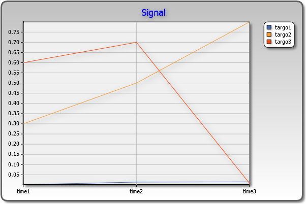

And this is what I get here:

Re: Legend with Custom Labels
Post by matt » Mon Mar 30, 2015 11:22 am
Thank you very much, ‘Problem 1’ is solved. But we need the checkboxes within the legend as soon as possible. Is there a schedule for this request?
