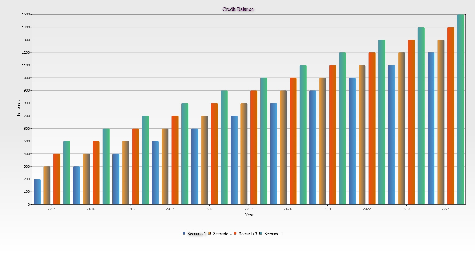

Hi, me again :)
What property do I use to get rid of the blur behind the title and legend text? (See the attachments). I have shadows turned off (format.shadow.visible=false).
Note that if I hide symbols in the legend, then all four of the legend texts have the blur like "Scenario 1".
Also, is there an equivalent to the VCL Legend.FontSeriesColor?

Now with attachments!

Post by Yeray » Wed Jul 02, 2014 11:57 am
Hi Jim,
Add this:
Chart1.legend.format.font.shadow.visible=false;

Post by Jim Green » Wed Jul 02, 2014 1:06 pm
Yeray, yes, that did it! Looks beautiful.
