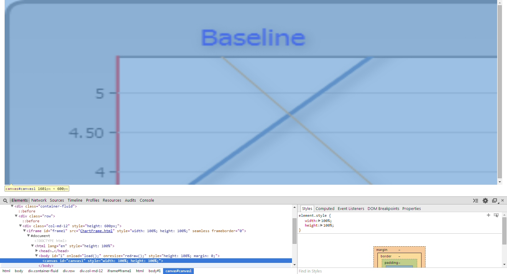

I'm not having any luck drawing a chart in a Canvas sized to 100% width and height. It looks magnified several times and only shows the upper left of the chart (though the title looks centered). I've attached a screen shot of a Chrome session with the developer tools open. (The chart lines are only visible because I had scrolled them into view.) The code to create the chart is:
   chart.panel.format.fill = "#F0F0F0";
   chart.title.text = "Baseline";
   chart.addSeries(new Tee.Line([5, 3, 2, 7, 1]));
   chart.addSeries(new Tee.Line([4, 4, 8, 2, 9])).visible = true;
   chart.series.items[0].format.stroke.size = 3;
   chart.axes.left.format.stroke.fill = "red";
I've also tried sizing the chart to the canvas:
  chart.bounds.width = chart.canvas.clientWidth;
  chart.bounds.height = chart.canvas.clientHeight;
  chart.draw();
Makes no difference.

However, adding this inside <head></head> gives me cut chart, that could be what you are observing:
<style type="text/css">
#canvas1, html
    width: 80%;
    height: 100%;
</style>
Is this what you are doing?

I don't see a problem with sizing the canvas. If you use:
<canvas id="Canvas1" style="height: 100%; width: 100%;">
and inspect the elements, the canvas is correctly sized. It's just that the chart doesn't draw correctly.
