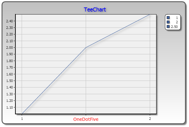

I add 3 points to simple line serie with X coordinates: 1, 1.5 and 2. Then I try to use onGetLabel to edit labels, but it seems that it doesn't fire for 1.5. Is it normal? If it is, how can I add custom label for point 1.5?

I've tried this and the axis label at 1.5 seems to be correctly caught:
  var s = Chart1.addSeries(new Tee.Line(Chart1));
  s.data.x=[1,1.5,2];
  s.data.values=[1,2,2.5];
  Chart1.axes.bottom.increment=0.5;
  Chart1.axes.bottom.setMinMax(0.95, 2.05);
  Chart1.axes.bottom.labels.ongetlabel=function(value,s) {
    if (value==1.5) {
       this.format.font.fill="red";
       this.format.font.style="14px Verdana";
       return "OneDotFive";
    else {
       this.format.font.fill="black";
       this.format.font.style="11px Tahoma";
       return s;
  Chart1.draw();
Are you using the latest TeeChart for JavaScript version?

The magic line was:
Now it works! Thank you for help!
