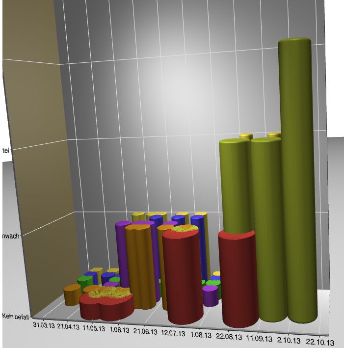

It seems there is a bug when using datetime axis and bars. The bar sizes are not consistent. The problem exists with both 2d and 3d. The bars overlap in 2d mode.
I am using the version v1.5 of Teechart
