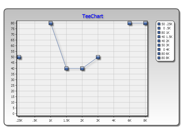

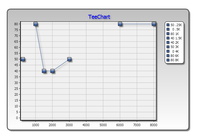

Re: Series Line skip and label questions
Post by Yeray » Wed Apr 17, 2013 1:19 pm
This is what I get with the code below and the actual sources we have here, isn't it what you are expecting?
If not, please, try to describe what are you expecting to achieve, or show it to us in a picture.
  var SerR=new Tee.Line();
  R1=50, R2=null, R3=80, R4=40, R5=40, R6=50, R7=null, R8=80, R9=80 ;
  SerR.data.values.clear;
  SerR.data.x = [250, 500, 1000, 1500, 2000, 3000, 4000, 6000, 8000];
  SerR.data.values = [R1, R2, R3, R4, R5, R6, R7, R8, R9];
  SerR.data.labels = [".25K", ".5K", "1K", "1.5K", "2K", "3K", "4K", "6K", "8K"];
  Chart1.addSeries(SerR).pointer.visible = true;
  Chart1.axes.bottom.increment = 1000;
  Chart1.axes.bottom.labels.labelStyle = "value";
