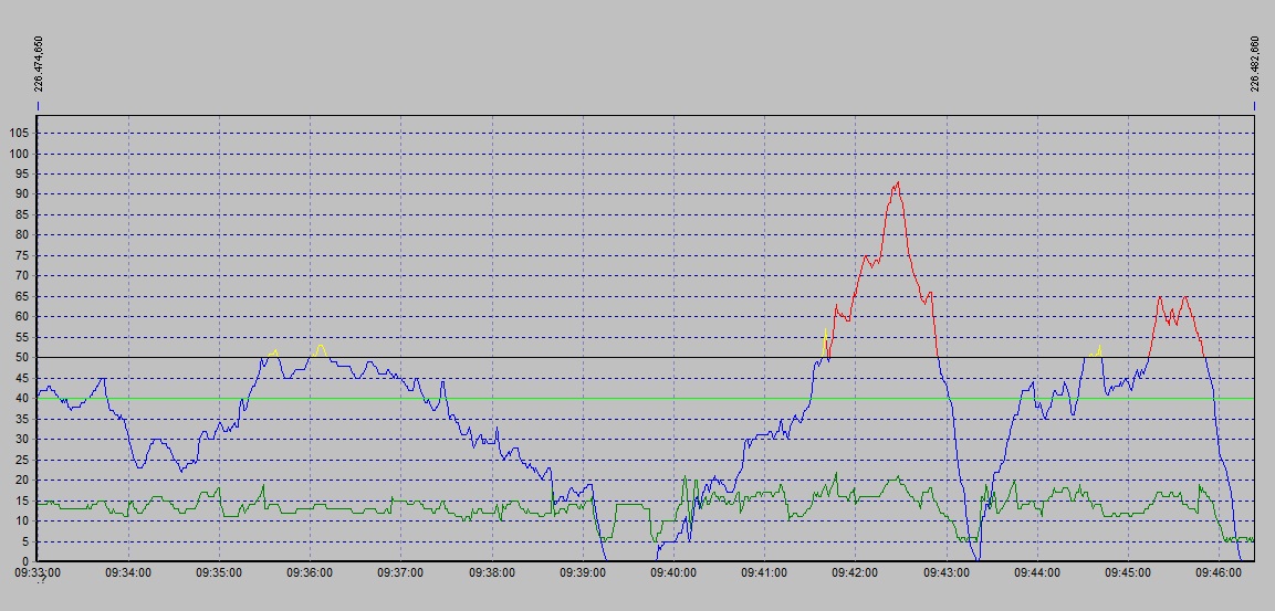

Dear friends,
I need to change the line color of a line chart based on a condition,
In one part blue and the other red.
As in the example file "chart.jpg."
Someone can tell me how can I do this?
Att
Osvano.

It looks to me like you cannot reproduce your example chart using a single Line series in the TeeChart. You can make your series' pointers visible and have a condition-based color for each pointer. Alternatively you can use a new Line series for each contiguous stretch of color that you want to display.

When you say
"You can make your series' pointers visible and have a condition-based color for each pointer" would be done like this?
You have to send me an example?

Something like the code below. This isn't particularly well-documented, but your question was interesting to me so I spent a little time looking through teechart.js to see what was available.
var Y = [{ array of series values } ];
var X = [{ array of series x-axis values } ];
var c = [{ array of HTML color values, one for each point in the series (ex. "#FF0000" ) } ];
var cht = new Tee.Chart("canvasID");
var srs = new Tee.Line();
srs.data.values = Y;
srs.data.x = X;
srs.palette.colors = c;
srs.colorEach = "yes";
srs.pointer.visible = true;
cht.addSeries(srs);
