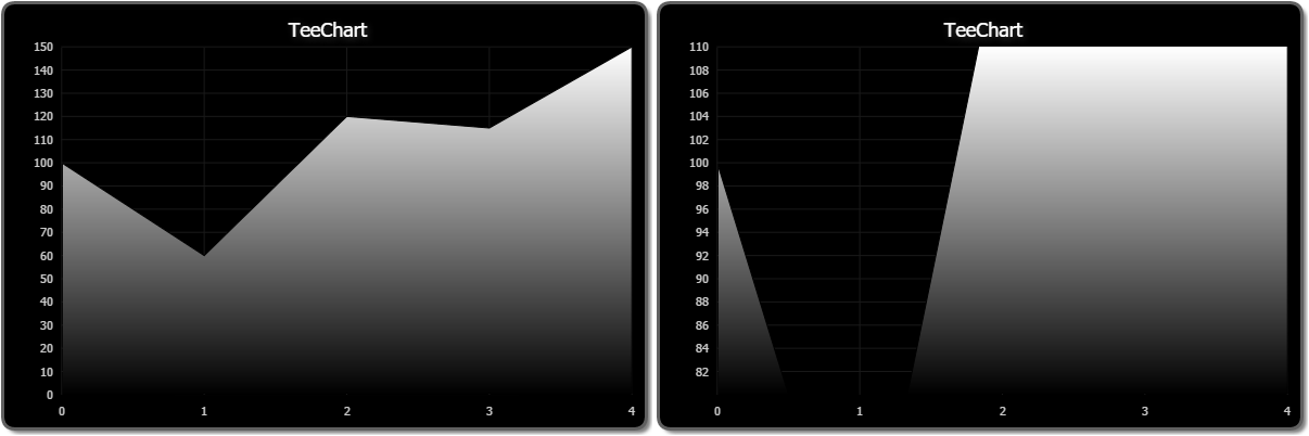

Area chart gradient bug
Re: Area chart gradient bug
Post by Yeray » Thu Dec 10, 2015 12:59 pm
Try overriding bounds function instead of minYValue:
  area2.bounds=function(r) {
    var h=this._horizAxis, v=this._vertAxis;
    r.x=h.calc(this.minXValue());
    r.width=h.calc(this.maxXValue())-r.x;
    r.y=v.calc(Chart2.axes.left.maximum);
    r.height=v.calc(Chart2.axes.left.minimum)-r.y;

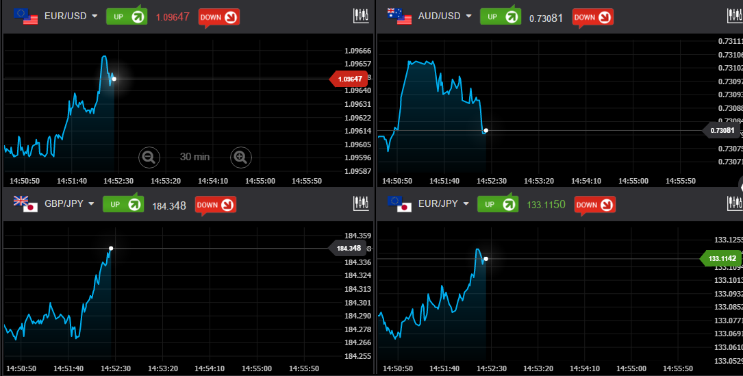

For our real chart we were using two areas (Line / Area). We just remove the Area and add some lines code to the end of doDrawLine() function in Line area:
           var gradient = a.createLinearGradient(0, a.canvas.height, 0, 0);
            gradient.addColorStop(0, "rgba(0, 175, 240, 0)");
            gradient.addColorStop(1, "rgba(0, 175, 240, 0.3)");
            a.fillStyle = gradient;
            var lastPointX = this.chart.axes.bottom.calc(this.maxXValue());
            a.lineTo(lastPointX, a.canvas.height);
            a.lineTo(0, a.canvas.height);
            a.fill();
As a result we have a good line/area chart with perfect gradient doesn't matter if we change the min/max:
Best regards!
