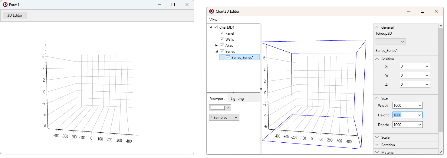

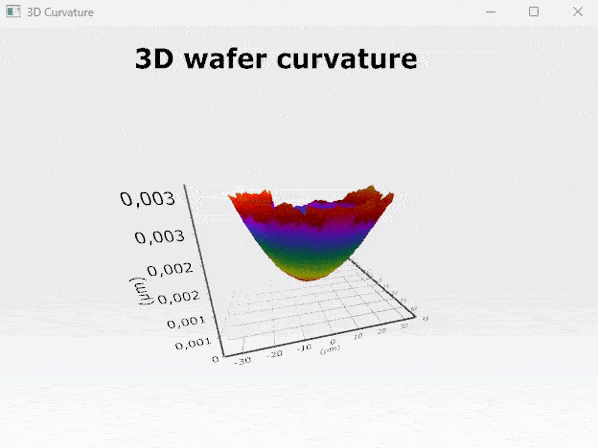

To demonstrate the performance I'm looking for, please find attached a project based on VCLTee I have assembled :
I believe FMXTee's Chart3D holds the answer to my question. It does seem to support hardware acceleration out of the box.
Unfortunately, within a Chart3D, trisurfaces don't render at all on my machine.
In the attachments, you'll find another project to illustrate this, here is its output on my machine :
Any idea what I might be missing ?

In the meantime, I had to move forward with my back-end development, among others. To do this, I wrapped a VCLTee Chart3D in a DLL for temporary use with my FMX application.
As demonstrated with the attached project below, it turns out VCLTee's TTriSurface only performs well with no new sample values filled :
This prevented me from directly feeding my non-regular grid data. Instead, I had to interpolate my data to a regular grid and use a TSurface, removing TTriSurfaces altogether:
With my back-end validated, I have to admit the front-end is turning into a liability. This is because:

The bug is about FMX TTriSurfaces not rendering within a chart3D. The relevant project is TriSurfaceInChart3D.zip :
Here’s a description and test plan for bug 2644 :

1 - Unzip, build and launch the project in 64-bit release mode.
2 - Click the upper left side "3D editor" button.
3 - Within the newly opened window, select the Series group in the left side treeview.
4 - Make sure Series1 is listed while TTriSurface doesn’t render in the Chart3D.
Can you please update bug 2644 ?
Please note that the TeeChart software version has been specified.
Please also note that this is not an enhancement, rather an anomaly resolution.
Thank you again for your help.
