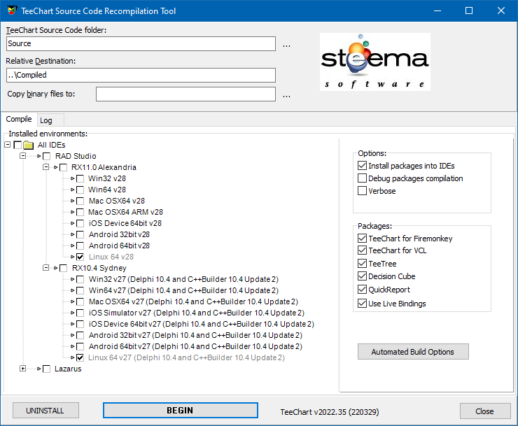

I'm trying to recompile the TeeCart VCL/FMX 2022.35 Source. (TeeChartVCLFMXSOURCE-2022.35.exe)
But when I select Linux option for both 10.4, 11 and press Begin seems like nothing happen.
[ Actually I'm wonder why it's like disabled (gray) ]
Should I have to clear cache or log file somewhere ?
I'm a bit new to TeeChart commercial since I mostly use the bundled version.
PS. I can select and compile successfully with TeeGrid 1.11 (TeeGrid-Registered-1.11.exe) though.

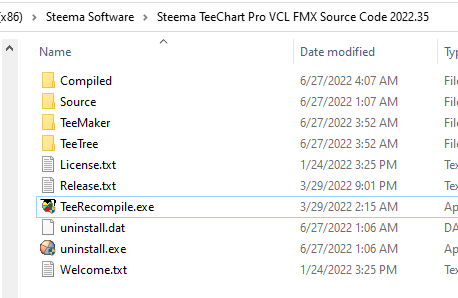

Run this TeeRecompile.exe with Administrator privilege.
When I select like this (even it's gray) and press BEGIN

Hi
FYI, My machine was setup by linux instruction guide and work well.
So I do this step in Command Prompt (Run as Admin)
> TeeRecompile -generateunits:27
> TeeRecompile -generateunits:28
Then I open TeeRecompile.exe again (as Admin). The Linux checkbox still did not work.
Gray out like the image I posted previously.
It's not about to compile my Linux app with TeeChart in Delphi,
it's about I can't compile TeeChart FMX for Linux.

Post by Yeray » Mon Jun 27, 2022 8:39 am
I'm afraid TeeChart can't be compiled for linux with TeeRecompile for now.

Hi @Yeray
Thank you for your comment.
I just wonder because it has Linux option as well as TeeGrid.
Also, the TeeGrid can be compile for Linux option.
