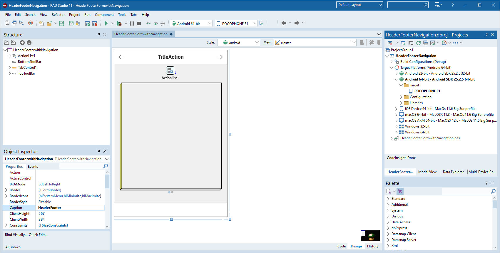

Can be tested so: In Delphi 11 & Win10-64bit-> New-> Multi Device Application-> Header/Footer with Navigation-> make destination folder it->
Add chart1 to form and press run. And it comes in my pc. Without chart just press run and no error.

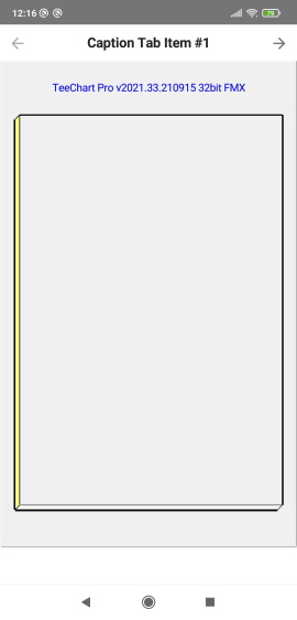

This seems to work fine for me here both with a Pocophone F1 and a Lenovo M10 tablet:

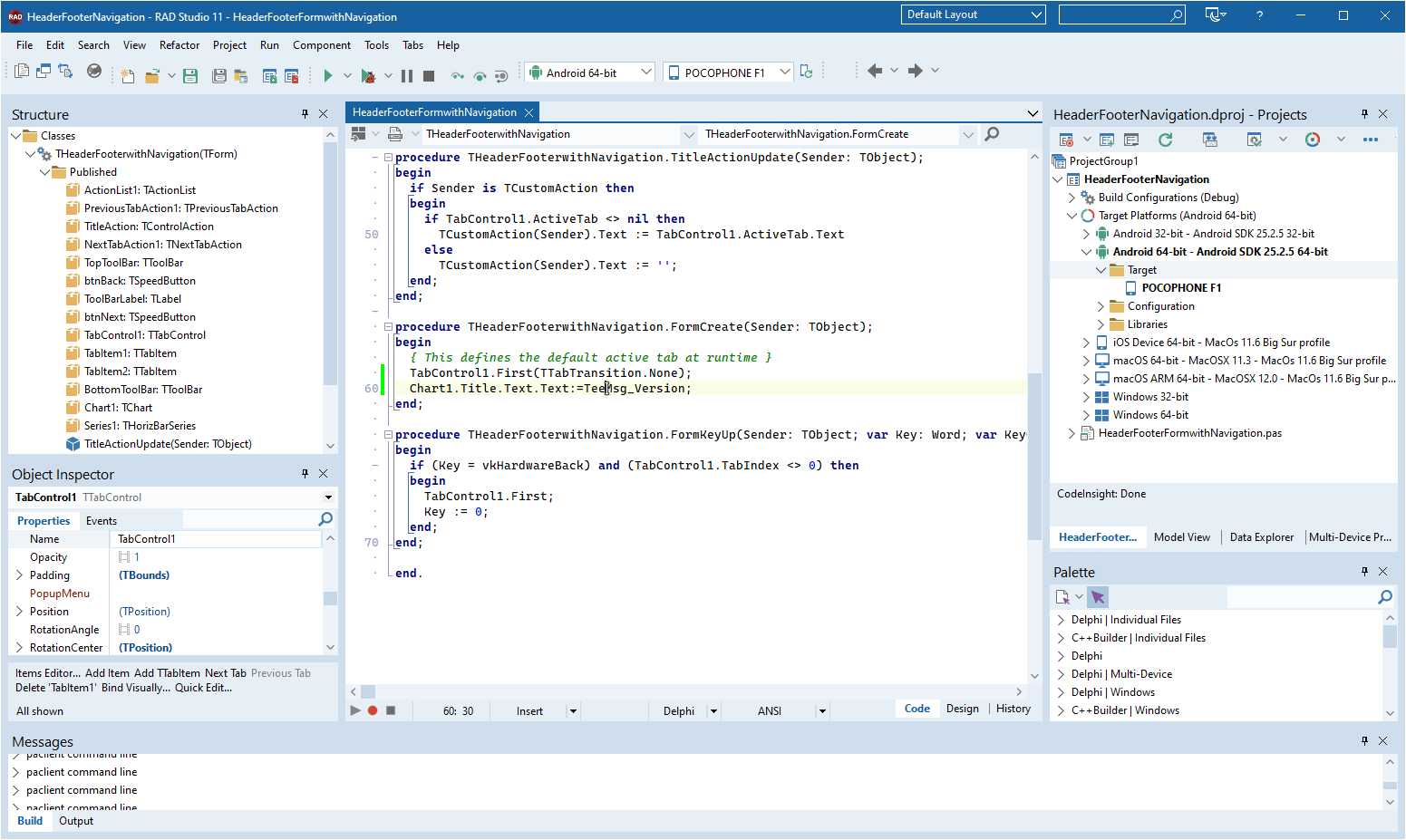

Note I've added the FMXTee.Constants unit and this code at the FormCreate, just to verify the version found by the compiler:
  Chart1.Title.Text.Text:=TeeMsg_Version;

I have same verson in title, but this FMXTee.Constants have'nt solved my issue. I have also write to Embarcadero that such problem exist and they have also tested and found it. You can download full test project from one of my site link, its about 70mb because of Android and Android 64 folders. http://www.dialab.ee/tmp/Multi3.rar
So You can add 64 bit unit as target for test and as im not only one who have that issue, then You should get it too.
