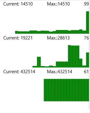

Is it possible to show a dynamic chart with fixed bar align and size?
I'd like to show my chart with vertical bars with width 5 and all them to right align.
On the follow attached example I built it using rectangles, so I just created the object in runtime and put it on the right side, I'd say my rectangle chart 'moves' from right to left.
I'd like to do something like that using TeeChart

I'm glad to hear you found a solution.
An alternative would be to play with CustomBarWidth or with the bottom axis scale SetMinMax(min, max).
