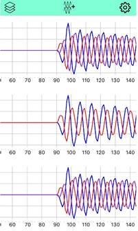

I've spent the day on a memory leak error (the minor Android issues i'll get back to). I can create one or more TeeChart's on a TScrollBox in my FMX app (i have a nice template chart that i just clone and add series to). It works fine - except, if i start scrolling up/down or left/right to see all of the charts and to see entire chart (horizontally) i start gobbling up memory. I'm watching my app performance via Xcode Console to see the messages. I'll eventually get a "Received memory warning" for my app and then it kills my app and gives me a kernal message, "EXC_RESOURCE -> myappname[5548] exceeded mem limit: ActiveHard 1400MB (fatal)". This does not occur when i run my app on Win32 - very stable memory usage.
On iOS If i just plot the charts and leave it alone no crash. But, that is obviously not a solution.
