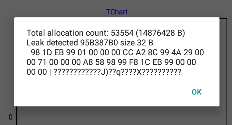

As far as I can see, I can't get much further with LeakCheck. I get this:

05-14 14:17:08.094 22707 22707 W leak    :   F8 79 F1 D5 02 00 00 00 AA 9C 08 D6 75 00 00 00 B0 C2 D1 D6 B0 47 F2 D4 00 00 00 00 00 00 00 00 | ?y??????????u????????G??????????
05-14 14:17:08.096 22707 22707 W leak    :   B9 9C 08 D6 38 9B 50 D4 90 07 08 D6 13 00 00 00 01 00 00 00 | ????8?P?????????????
05-14 14:17:08.097 22707 22707 W leak    : Leak detected D4509B30 size 16 B
05-14 14:17:08.098 22707 22707 W leak    :   01 00 00 00 02 00 00 00 30 AF 50 D4 30 B4 50 D4 | ????????0?P?0?P?
05-14 14:17:08.100 22707 22707 W leak    : Leak detected D450A7B0 size 44 B
05-14 14:17:08.101 22707 22707 W leak    :   CC 78 F1 D5 01 00 00 00 BC 9C 08 D6 1A 00 00 00 B0 C2 D1 D6 30 A5 50 D4 00 00 00 00 BC AC 50 D4 | ?x??????????????????0?P???????P?
05-14 14:17:08.102 22707 22707 W leak    :   08 00 00 00 F8 99 08 D6 00 00 00 00 | ????????????
05-14 14:17:08.104 22707 22707 W leak    : Leak detected D450ACB0 size 22 B for UnicodeString {RefCount: 1} = Self
05-14 14:17:08.105 22707 22707 W leak    : Leak detected D450AF30 size 44 B
05-14 14:17:08.106 22707 22707 W leak    :   CC 78 F1 D5 02 00 00 00 D6 9C 08 D6 16 00 00 00 B0 C2 D1 D6 30 A5 50 D4 00 00 00 00 BC B1 50 D4 | ?x??????????????????0?P???????P?
05-14 14:17:08.108 22707 22707 W leak    :   00 00 00 00 C8 72 EC D5 00 00 00 00 | ?????r??????
05-14 14:17:08.109 22707 22707 W leak    : Leak detected D450B1B0 size 26 B for UnicodeString {RefCount: 1} = cookie
05-14 14:17:08.110 22707 22707 W leak    : Leak detected D450B430 size 44 B
05-14 14:17:08.112 22707 22707 W leak    :   CC 78 F1 D5 02 00 00 00 EC 9C 08 D6 18 00 00 00 B0 C2 D1 D6 30 A5 50 D4 00 00 00 00 BC B6 50 D4 | ?x??????????????????0?P???????P?
05-14 14:17:08.113 22707 22707 W leak    :   08 00 00 00 64 DE F9 D5 00 00 00 00 | ????d???????
05-14 14:17:08.114 22707 22707 W leak    : Leak detected D450B6B0 size 30 B for UnicodeString {RefCount: 1} = fileName
05-14 14:17:08.116 22707 22707 W leak    : Leak detected D450B930 size 52 B
05-14 14:17:08.117 22707 22707 W leak    :   F8 79 F1 D5 02 00 00 00 1F 9D 08 D6 64 00 00 00 B0 C2 D1 D6 B0 47 F2 D4 00 00 00 00 00 00 00 00 | ?y??????????d????????G??????????
05-14 14:17:08.118 22707 22707 W leak    :   35 9D 08 D6 38 AA 50 D4 D4 FE 0A D6 14 00 00 00 01 00 00 00 | 5???8?P?????????????
05-14 14:17:08.119 22707 22707 W leak    : Leak detected D450AA30 size 12 B
05-14 14:17:08.121 22707 22707 W leak    :   01 00 00 00 01 00 00 00 30 C3 50 D4 | ????????0?P?
05-14 14:17:08.122 22707 22707 W leak    : Leak detected D450BBB0 size 44 B
05-14 14:17:08.123 22707 22707 W leak    :   CC 78 F1 D5 01 00 00 00 38 9D 08 D6 1A 00 00 00 B0 C2 D1 D6 30 B9 50 D4 00 00 00 00 BC C0 50 D4 | ?x??????8???????????0?P???????P?
05-14 14:17:08.124 22707 22707 W leak    :   08 00 00 00 F8 99 08 D6 00 00 00 00 | ????????????
05-14 14:17:08.126 22707 22707 W leak    : Leak detected D450C0B0 size 22 B for UnicodeString {RefCount: 1} = Self
05-14 14:17:08.127 22707 22707 W leak    : Leak detected D450C330 size 44 B
05-14 14:17:08.128 22707 22707 W leak    :   CC 78 F1 D5 02 00 00 00 52 9D 08 D6 18 00 00 00 B0 C2 D1 D6 30 B9 50 D4 00 00 00 00 BC C5 50 D4 | ?x??????R???????????0?P???????P?
05-14 14:17:08.129 22707 22707 W leak    :   08 00 00 00 64 DE F9 D5 00 00 00 00 | ????d???????
05-14 14:17:08.131 22707 22707 W leak    : Leak detected D450C5B0 size 30 B for UnicodeString {RefCount: 1} = fileName
05-14 14:17:08.132 22707 22707 W leak    : Leak detected D450C830 size 52 B
05-14 14:17:08.133 22707 22707 W leak    :   F8 79 F1 D5 02 00 00 00 83 9D 08 D6 7A 00 00 00 B0 C2 D1 D6 B0 47 F2 D4 00 00 00 00 00 00 00 00 | ?y??????????z????????G??????????
05-14 14:17:08.134 22707 22707 W leak    :   99 9D 08 D6 38 BE 50 D4 D4 FE 0A D6 15 00 00 00 01 00 00 00 | ????8?P?????????????
05-14 14:17:08.136 22707 22707 W leak    : Leak detected D450BE30 size 16 B
05-14 14:17:08.137 22707 22707 W leak    :   01 00 00 00 02 00 00 00 30 D2 50 D4 30 D7 50 D4 | ????????0?P?0?P?
05-14 14:17:08.138 22707 22707 W leak    : Leak detected D450CAB0 size 44 B
05-14 14:17:08.139 22707 22707 W leak    :   CC 78 F1 D5 01 00 00 00 9C 9D 08 D6 1A 00 00 00 B0 C2 D1 D6 30 C8 50 D4 00 00 00 00 BC CF 50 D4 | ?x??????????????????0?P???????P?
05-14 14:17:08.141 22707 22707 W leak    :   08 00 00 00 F8 99 08 D6 00 00 00 00 | ????????????
05-14 14:17:08.142 22707 22707 W leak    : Leak detected D450CFB0 size 22 B for UnicodeString {RefCount: 1} = Self
05-14 14:17:08.143 22707 22707 W leak    : Leak detected D450D230 size 44 B
05-14 14:17:08.144 22707 22707 W leak    :   CC 78 F1 D5 02 00 00 00 B6 9D 08 D6 16 00 00 00 B0 C2 D1 D6 30 C8 50 D4 00 00 00 00 BC D4 50 D4 | ?x??????????????????0?P???????P?
05-14 14:17:08.146 22707 22707 W leak    :   00 00 00 00 C8 72 EC D5 00 00 00 00 | ?????r??????
05-14 14:17:08.147 22707 22707 W leak    : Leak detected D450D4B0 size 26 B for UnicodeString {RefCount: 1} = cookie
05-14 14:17:08.148 22707 22707 W leak    : Leak detected D450D730 size 44 B
05-14 14:17:08.149 22707 22707 W leak    :   CC 78 F1 D5 02 00 00 00 CC 9D 08 D6 18 00 00 00 B0 C2 D1 D6 30 C8 50 D4 00 00 00 00 BC D9 50 D4 | ?x??????????????????0?P???????P?
05-14 14:17:08.151 22707 22707 W leak    :   08 00 00 00 64 DE F9 D5 00 00 00 00 | ????d???????
05-14 14:17:08.152 22707 22707 W leak    : Leak detected D450D9B0 size 30 B for UnicodeString {RefCount: 1} = fileName
05-14 14:17:08.153 22707 22707 W leak    : Leak detected D450DC30 size 32 B
05-14 14:17:08.154 22707 22707 W leak    :   C0 13 F1 D5 01 00 00 00 CC 92 EC D5 C4 DE 50 D4 B8 FC 50 D4 00 00 00 00 20 13 F1 D5 00 00 00 00 | ??????????????P???P????? ???????
05-14 14:17:08.156 22707 22707 W leak    : Leak detected D450DEB0 size 28 B
05-14 14:17:08.157 22707 22707 W leak    :   08 A9 F0 D5 01 00 00 00 CC 92 EC D5 38 E1 50 D4 01 00 00 00 68 A8 F0 D5 00 00 00 00 | ????????????8?P?????h???????
05-14 14:17:08.158 22707 22707 W leak    : Leak detected D450F030 size 78 B for UnicodeString {RefCount: 2} = android/content/res/AssetManager
05-14 14:17:08.160 22707 22707 W leak    : Leak detected D450F7B0 size 16 B
05-14 14:17:08.161 22707 22707 W leak    :   C4 55 F8 D5 02 00 00 00 3C F0 50 D4 00 00 00 00 | ?U??????<?P?????
05-14 14:17:08.162 22707 22707 W leak    : Leak detected D450FCB0 size 12 B
05-14 14:17:08.163 22707 22707 W leak    :   01 00 00 00 01 00 00 00 B0 F7 50 D4 | ??????????P?
05-14 14:17:08.165 22707 22707 W leak    : Leak detected D450E130 size 24 B
05-14 14:17:08.166 22707 22707 W leak    :   01 00 00 00 04 00 00 00 B0 F7 50 D4 00 00 00 00 00 00 00 00 00 00 00 00 | ??????????P?????????????
05-14 14:17:08.167 22707 22707 W leak    : Leak detected D45FF5B0 size 40 B
05-14 14:17:08.169 22707 22707 W leak    :   74 E7 EF D5 01 00 00 00 84 17 FA D5 6D 0A 00 00 B0 C2 D1 D6 00 00 00 00 C8 AA 52 D4 38 2F 05 E7 | t???????????m?????????????R?8/??
05-14 14:17:08.170 22707 22707 W leak    :   38 00 00 00 01 00 00 00 | 8???????
05-14 14:17:08.171 22707 22707 W leak    : Leak detected E7052F30 size 184 B
05-14 14:17:08.172 22707 22707 W leak    :   01 00 00 00 2C 00 00 00 30 FA 50 D4 B0 ED 50 D4 30 FF 50 D4 B0 06 51 D4 B0 15 51 D4 30 1D 51 D4 | ????,???0?P???P?0?P???Q???Q?0?Q?
05-14 14:17:08.174 22707 22707 W leak    :   B0 24 51 D4 30 2C 51 D4 30 3B 51 D4 B0 42 51 D4 30 4A 51 D4 B0 51 51 D4 30 59 51 D4 B0 60 51 D4 | ?$Q?0,Q?0;Q??BQ?0JQ??QQ?0YQ??`Q?
05-14 14:17:08.175 22707 22707 W leak    :   30 68 51 D4 B0 6F 51 D4 30 77 51 D4 B0 7E 51 D4 30 86 51 D4 B0 8D 51 D4 30 95 51 D4 B0 9C 51 D4 | 0hQ??oQ?0wQ??~Q?0?Q???Q?0?Q???Q?
05-14 14:17:08.176 22707 22707 W leak    :   30 A4 51 D4 B0 AB 51 D4 30 B3 51 D4 B0 BA 51 D4 30 C2 51 D4 B0 C9 51 D4 30 D1 51 D4 30 E0 51 D4 | 0?Q???Q?0?Q???Q?0?Q???Q?0?Q?0?Q?
05-14 14:17:08.178 22707 22707 W leak    :   B0 E7 51 D4 B0 F6 51 D4 B0 05 52 D4 30 0D 52 D4 B0 14 52 D4 B0 23 52 D4 B0 37 52 D4 B0 46 52 D4 | ??Q???Q???R?0?R???R??#R??7R??FR?
05-14 14:17:08.179 22707 22707 W leak    :   B0 55 52 D4 30 5D 52 D4 30 71 52 D4 30 80 52 D4 30 94 52 D4 30 A3 52 D4 | ?UR?0]R?0qR?0?R?0?R?0?R?
05-14 14:17:08.180 22707 22707 W leak    : Leak detected D450FA30 size 52 B
05-14 14:17:08.182 22707 22707 W leak    :   F8 79 F1 D5 02 00 00 00 BD 17 FA D5 2E 00 00 00 B0 C2 D1 D6 B0 F5 5F D4 00 00 00 00 00 00 00 00 | ?y??????????.?????????_?????????
05-14 14:17:08.183 22707 22707 W leak    :   C8 17 FA D5 00 00 00 00 3A 72 EC D5 0C 00 00 00 01 00 00 00 | ????????:r??????????
05-14 14:17:08.184 22707 22707 W leak    : Leak detected D450E630 size 44 B
05-14 14:17:08.185 22707 22707 W leak    :   CC 78 F1 D5 01 00 00 00 CB 17 FA D5 12 00 00 00 B0 C2 D1 D6 30 FA 50 D4 00 00 00 00 3C EB 50 D4 | ?x??????????????????0?P?????<?P?
05-14 14:17:08.187 22707 22707 W leak    :   08 00 00 00 80 17 FA D5 00 00 00 00 | ????????????
05-14 14:17:08.188 22707 22707 W leak    : Leak detected D450EB30 size 22 B for UnicodeString {RefCount: 1} = Self
05-14 14:17:08.189 22707 22707 W leak    : Leak detected D450EDB0 size 52 B
05-14 14:17:08.190 22707 22707 W leak    :   F8 79 F1 D5 02 00 00 00 EB 17 FA D5 2B 00 00 00 B0 C2 D1 D6 B0 F5 5F D4 00 00 00 00 00 00 00 00 | ?y??????????+?????????_?????????
05-14 14:17:08.192 22707 22707 W leak    :   F3 17 FA D5 00 00 00 00 3A 72 EC D5 0D 00 00 00 01 00 00 00 | ????????:r??????????
05-14 14:17:08.193 22707 22707 W leak    : Leak detected D450E8B0 size 44 B
05-14 14:17:08.194 22707 22707 W leak    :   CC 78 F1 D5 01 00 00 00 F6 17 FA D5 12 00 00 00 B0 C2 D1 D6 B0 ED 50 D4 00 00 00 00 3C F5 50 D4 | ?x????????????????????P?????<?P?
05-14 14:17:08.195 22707 22707 W leak    :   08 00 00 00 80 17 FA D5 00 00 00 00 | ????????????
05-14 14:17:08.197 22707 22707 W leak    : Leak detected D450F530 size 22 B for UnicodeString {RefCount: 1} = Self
05-14 14:17:08.198 22707 22707 W leak    : Leak detected D450FF30 size 52 B
05-14 14:17:08.199 22707 22707 W leak    :   F8 79 F1 D5 02 00 00 00 16 18 FA D5 2C 00 00 00 B0 C2 D1 D6 B0 F5 5F D4 00 00 00 00 00 00 00 00 | ?y??????????,?????????_?????????
05-14 14:17:08.201 22707 22707 W leak    :   1F 18 FA D5 00 00 00 00 3A 72 EC D5 0E 00 00 00 01 00 00 00 | ????????:r??????????
05-14 14:17:08.202 22707 22707 W leak    : Leak detected D450F2B0 size 44 B
05-14 14:17:08.203 22707 22707 W leak    :   CC 78 F1 D5 01 00 00 00 22 18 FA D5 12 00 00 00 B0 C2 D1 D6 30 FF 50 D4 00 00 00 00 3C 04 51 D4 | ?x??????"???????????0?P?????<?Q?
05-14 14:17:08.204 22707 22707 W leak    :   08 00 00 00 80 17 FA D5 00 00 00 00 | ????????????
05-14 14:17:08.206 22707 22707 W leak    : Leak detected D4510430 size 22 B for UnicodeString {RefCount: 1} = Self
05-14 14:17:08.207 22707 22707 W leak    : Leak detected D45106B0 size 52 B
05-14 14:17:08.208 22707 22707 W leak    :   F8 79 F1 D5 02 00 00 00 42 18 FA D5 42 00 00 00 B0 C2 D1 D6 B0 F5 5F D4 00 00 00 00 00 00 00 00 | ?y??????B???B?????????_?????????
05-14 14:17:08.209 22707 22707 W leak    :   4C 18 FA D5 B8 01 51 D4 CC 72 EC D5 0F 00 00 00 01 00 00 00 | L?????Q??r??????????
05-14 14:17:08.211 22707 22707 W leak    : Leak detected D45101B0 size 12 B
05-14 14:17:08.212 22707 22707 W leak    :   01 00 00 00 01 00 00 00 B0 10 51 D4 | ??????????Q?
05-14 14:17:08.213 22707 22707 W leak    : Leak detected D4510930 size 44 B
05-14 14:17:08.214 22707 22707 W leak    :   CC 78 F1 D5 01 00 00 00 4F 18 FA D5 12 00 00 00 B0 C2 D1 D6 B0 06 51 D4 00 00 00 00 3C 0E 51 D4 | ?x??????O?????????????Q?????<?Q?
05-14 14:17:08.216 22707 22707 W leak    :   08 00 00 00 80 17 FA D5 00 00 00 00 | ????????????
05-14 14:17:08.217 22707 22707 W leak    : Leak detected D4510E30 size 22 B for UnicodeString {RefCount: 1} = Self
05-14 14:17:08.218 22707 22707 W leak    : Leak detected D45110B0 size 44 B
05-14 14:17:08.219 22707 22707 W leak    :   CC 78 F1 D5 02 00 00 00 61 18 FA D5 15 00 00 00 B0 C2 D1 D6 B0 06 51 D4 00 00 00 00 3C 13 51 D4 | ?x??????a?????????????Q?????<?Q?
05-14 14:17:08.220 22707 22707 W leak    :   08 00 00 00 80 17 FA D5 00 00 00 00 | ????????????
05-14 14:17:08.222 22707 22707 W leak    : Leak detected D4511330 size 28 B for UnicodeString {RefCount: 1} = another
05-14 14:17:08.223 22707 22707 W leak    : Leak detected D45115B0 size 52 B
05-14 14:17:08.224 22707 22707 W leak    :   F8 79 F1 D5 02 00 00 00 84 18 FA D5 31 00 00 00 B0 C2 D1 D6 B0 F5 5F D4 00 00 00 00 00 00 00 00 | ?y??????????1?????????_?????????
05-14 14:17:08.225 22707 22707 W leak    :   92 18 FA D5 00 00 00 00 3A 72 EC D5 10 00 00 00 01 00 00 00 | ????????:r??????????
05-14 14:17:08.227 22707 22707 W leak    : Leak detected D4510BB0 size 44 B
05-14 14:17:08.228 22707 22707 W leak    :   CC 78 F1 D5 01 00 00 00 95 18 FA D5 12 00 00 00 B0 C2 D1 D6 B0 15 51 D4 00 00 00 00 BC 1A 51 D4 | ?x????????????????????Q???????Q?
05-14 14:17:08.229 22707 22707 W leak    :   08 00 00 00 80 17 FA D5 00 00 00 00 | ????????????
05-14 14:17:08.230 22707 22707 W leak    : Leak detected D4511AB0 size 22 B for UnicodeString {RefCount: 1} = Self
05-14 14:17:08.232 22707 22707 W leak    : Leak detected D4511D30 size 52 B
05-14 14:17:08.233 22707 22707 W leak    :   F8 79 F1 D5 02 00 00 00 B5 18 FA D5 2A 00 00 00 B0 C2 D1 D6 B0 F5 5F D4 00 00 00 00 00 00 00 00 | ?y??????????*?????????_?????????
05-14 14:17:08.234 22707 22707 W leak    :   BC 18 FA D5 00 00 00 00 3A 72 EC D5 11 00 00 00 01 00 00 00 | ????????:r??????????
05-14 14:17:08.236 22707 22707 W leak    : Leak detected D4511830 size 44 B
05-14 14:17:08.237 22707 22707 W leak    :   CC 78 F1 D5 01 00 00 00 BF 18 FA D5 12 00 00 00 B0 C2 D1 D6 30 1D 51 D4 00 00 00 00 3C 22 51 D4 | ?x??????????????????0?Q?????<"Q?
05-14 14:17:08.239 22707 22707 W leak    :   08 00 00 00 80 17 FA D5 00 00 00 00 | ????????????
05-14 14:17:08.240 22707 22707 W leak    : Leak detected D4512230 size 22 B for UnicodeString {RefCount: 1} = Self
05-14 14:17:08.241 22707 22707 W leak    : Leak detected D45124B0 size 52 B
05-14 14:17:08.243 22707 22707 W leak    :   F8 79 F1 D5 02 00 00 00 DF 18 FA D5 24 00 00 00 B0 C2 D1 D6 B0 F5 5F D4 00 00 00 00 00 00 00 00 | ?y??????????$?????????_?????????
05-14 14:17:08.244 22707 22707 W leak    :   EC 18 FA D5 00 00 00 00 00 00 00 00 12 00 00 00 01 00 00 00 | ????????????????????
05-14 14:17:08.245 22707 22707 W leak    : Leak detected D4511FB0 size 44 B
05-14 14:17:08.246 22707 22707 W leak    :   CC 78 F1 D5 01 00 00 00 EF 18 FA D5 12 00 00 00 B0 C2 D1 D6 B0 24 51 D4 00 00 00 00 BC 29 51 D4 | ?x???????????????????$Q??????)Q?
05-14 14:17:08.248 22707 22707 W leak    :   08 00 00 00 80 17 FA D5 00 00 00 00 | ????????????
05-14 14:17:08.249 22707 22707 W leak    : Leak detected D45129B0 size 22 B for UnicodeString {RefCount: 1} = Self
05-14 14:17:08.250 22707 22707 W leak    : Leak detected D4512C30 size 52 B
05-14 14:17:08.251 22707 22707 W leak    :   F8 79 F1 D5 02 00 00 00 03 19 FA D5 3D 00 00 00 B0 C2 D1 D6 B0 F5 5F D4 00 00 00 00 00 00 00 00 | ?y??????????=?????????_?????????
05-14 14:17:08.252 22707 22707 W leak    :   0A 19 FA D5 38 27 51 D4 3A 72 EC D5 13 00 00 00 01 00 00 00 | ????8'Q?:r??????????
05-14 14:17:08.254 22707 22707 W leak    : Leak detected D4512730 size 12 B
05-14 14:17:08.255 22707 22707 W leak    :   01 00 00 00 01 00 00 00 30 36 51 D4 | ????????06Q?
05-14 14:17:08.256 22707 22707 W leak    : Leak detected D4512EB0 size 44 B
05-14 14:17:08.258 22707 22707 W leak    :   CC 78 F1 D5 01 00 00 00 0D 19 FA D5 12 00 00 00 B0 C2 D1 D6 30 2C 51 D4 00 00 00 00 BC 33 51 D4 | ?x??????????????????0,Q??????3Q?
05-14 14:17:08.259 22707 22707 W leak    :   08 00 00 00 80 17 FA D5 00 00 00 00 | ????????????
05-14 14:17:08.260 22707 22707 W leak    : Leak detected D45133B0 size 22 B for UnicodeString {RefCount: 1} = Self
05-14 14:17:08.261 22707 22707 W leak    : Leak detected D4513630 size 44 B
05-14 14:17:08.262 22707 22707 W leak    :   CC 78 F1 D5 02 00 00 00 1F 19 FA D5 13 00 00 00 B0 C2 D1 D6 30 2C 51 D4 00 00 00 00 BC 38 51 D4 | ?x??????????????????0,Q??????8Q?
05-14 14:17:08.263 22707 22707 W leak    :   08 00 00 00 94 CD F9 D5 00 00 00 00 | ????????????
05-14 14:17:08.265 22707 22707 W leak    : Leak detected D45138B0 size 20 B for UnicodeString {RefCount: 1} = obj
05-14 14:17:08.266 22707 22707 W leak    : Leak detected D4513B30 size 52 B
05-14 14:17:08.267 22707 22707 W leak    :   F8 79 F1 D5 02 00 00 00 40 19 FA D5 2A 00 00 00 B0 C2 D1 D6 B0 F5 5F D4 00 00 00 00 00 00 00 00 | ?y??????@???*?????????_?????????
05-14 14:17:08.268 22707 22707 W leak    :   47 19 FA D5 00 00 00 00 3A 72 EC D5 14 00 00 00 01 00 00 00 | G???????:r??????????
05-14 14:17:08.269 22707 22707 W leak    : Leak detected D4513130 size 44 B
05-14 14:17:08.271 22707 22707 W leak    :   CC 78 F1 D5 01 00 00 00 4A 19 FA D5 12 00 00 00 B0 C2 D1 D6 30 3B 51 D4 00 00 00 00 3C 40 51 D4 | ?x??????J???????????0;Q?????<@Q?
05-14 14:17:08.272 22707 22707 W leak    :   08 00 00 00 80 17 FA D5 00 00 00 00 | ????????????
05-14 14:17:08.273 22707 22707 W leak    : Leak detected D4514030 size 22 B for UnicodeString {RefCount: 1} = Self
05-14 14:17:08.275 22707 22707 W leak    : Leak detected D45142B0 size 52 B
05-14 14:17:08.276 22707 22707 W leak    :   F8 79 F1 D5 02 00 00 00 6A 19 FA D5 31 00 00 00 B0 C2 D1 D6 B0 F5 5F D4 00 00 00 00 00 00 00 00 | ?y??????j???1?????????_?????????
05-14 14:17:08.277 22707 22707 W leak    :   7A 19 FA D5 00 00 00 00 84 17 FA D5 15 00 00 00 01 00 00 00 | z???????????????????
05-14 14:17:08.278 22707 22707 W leak    : Leak detected D4513DB0 size 44 B
05-14 14:17:08.279 22707 22707 W leak    :   CC 78 F1 D5 01 00 00 00 7D 19 FA D5 12 00 00 00 B0 C2 D1 D6 B0 42 51 D4 00 00 00 00 BC 47 51 D4 | ?x??????}????????????BQ??????GQ?
05-14 14:17:08.281 22707 22707 W leak    :   08 00 00 00 80 17 FA D5 00 00 00 00 | ????????????
05-14 14:17:08.282 22707 22707 W leak    : Leak detected D45147B0 size 22 B for UnicodeString {RefCount: 1} = Self
05-14 14:17:08.283 22707 22707 W leak    : Leak detected D4514A30 size 52 B
05-14 14:17:08.284 22707 22707 W leak    :   F8 79 F1 D5 02 00 00 00 9B 19 FA D5 33 00 00 00 B0 C2 D1 D6 B0 F5 5F D4 00 00 00 00 00 00 00 00 | ?y??????????3?????????_?????????
