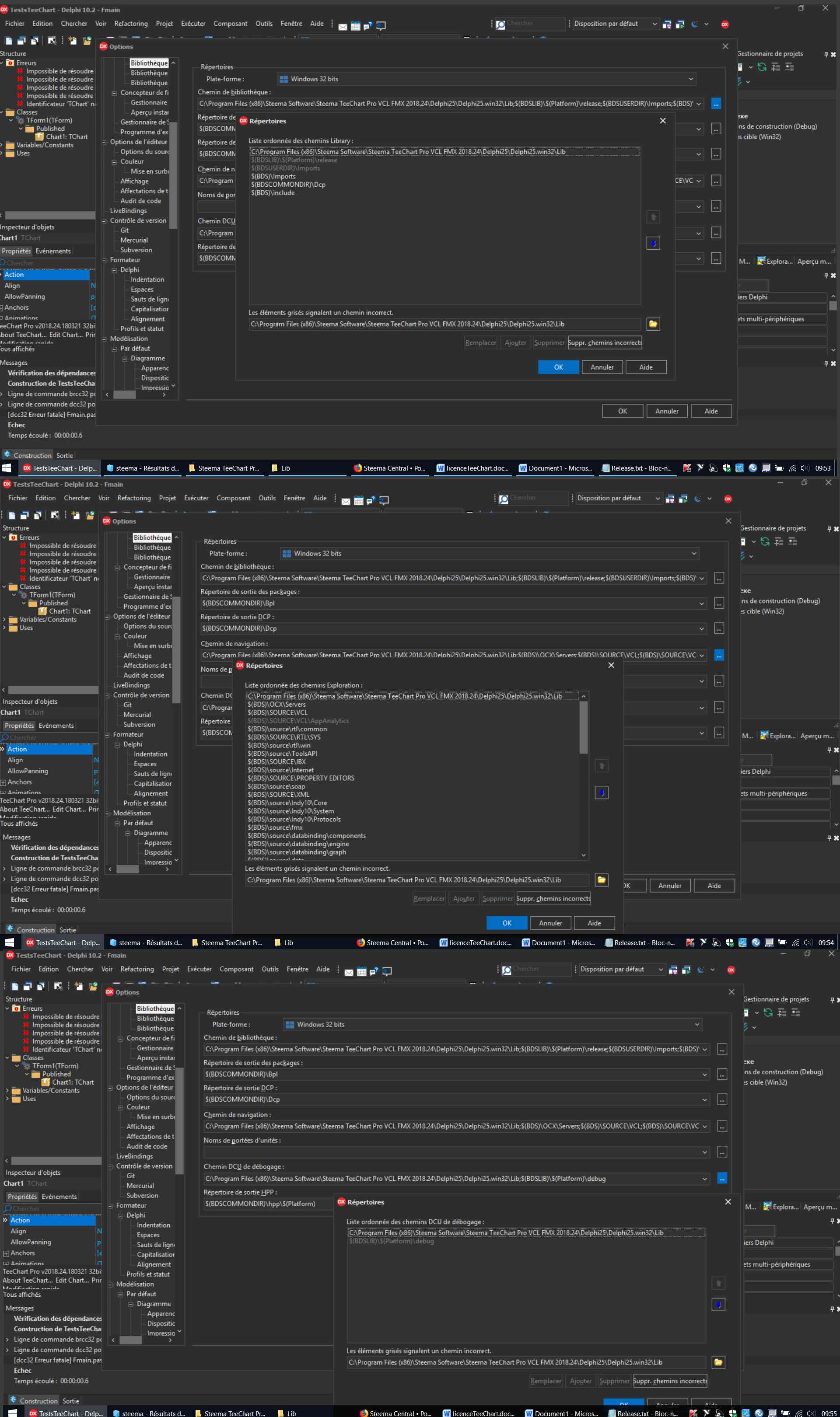

Hello
I installed Teechart pro 2018.24 on RAD Studio Delphi 10.2 Version 25.0.28979.1978.

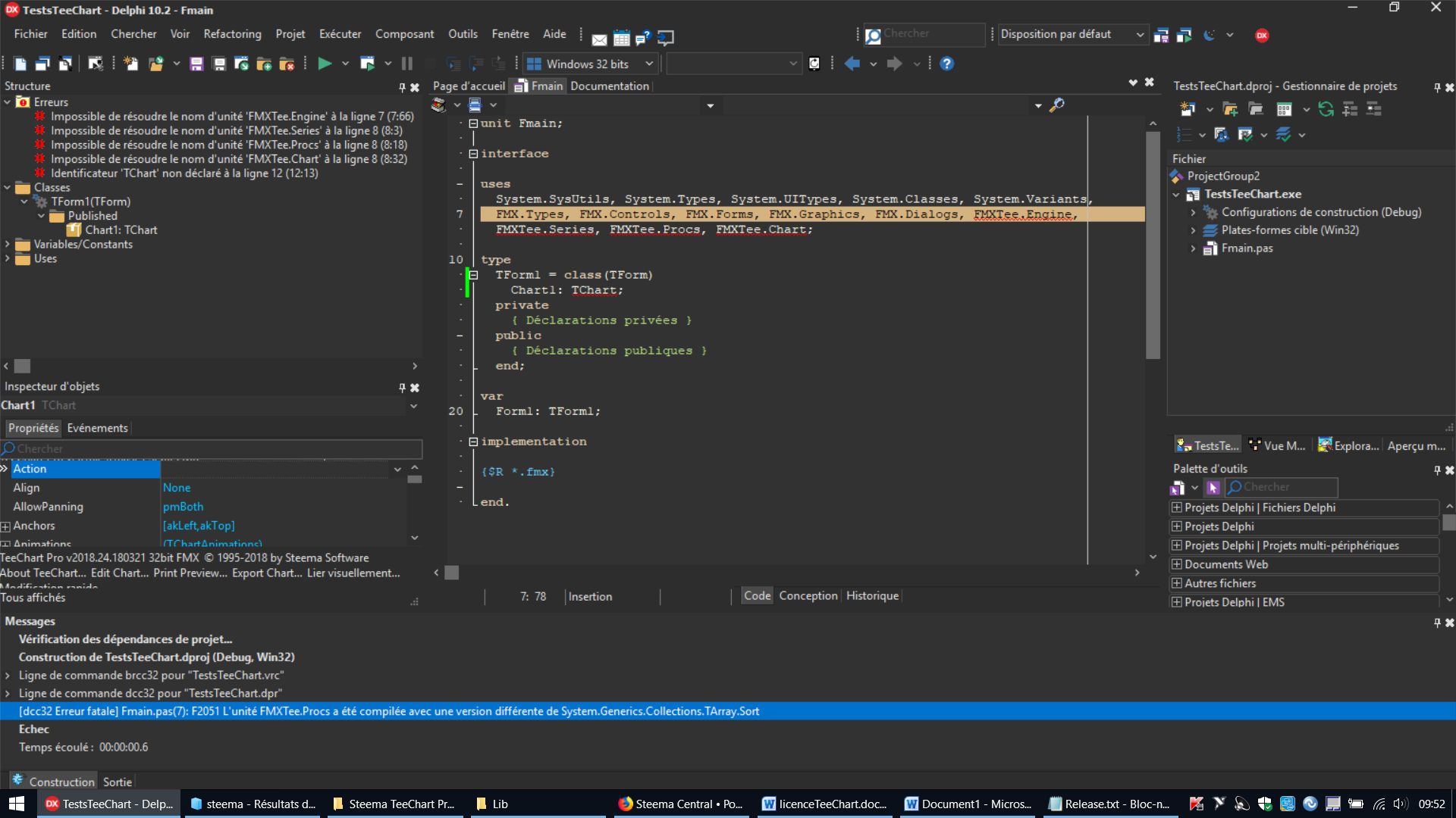

I tried to compile a simple project with a single TChart object and no additionnal code. It didn't work.
I unistalled light and pro versions of teeChart, re-install pro version, redefined paths for dcu files and navigation for win32 and android. It still doesn't work.
The error message is "[dcc32 Erreur fatale] Fmain.pas(7): F2051 L'unité FMXTee.Procs a été compilée avec une version différente de System.Generics.Collections.TArray.Sort"
Thank you for your help
Paths redefinition.jpg (349.46 KiB) Viewed 16080 times

I solved the problem. I uninstalled TeeChart, and RAD studio, then I installed latest version of RAD studio, and installed and reinstalled Teechart.
