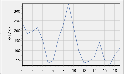

If I use the LeftAxis if then code then I get the following
If I use the CustomAxis if then code then I get the following
The only difference in the above is which axes is being used, Left or Custom.
I would expect to get the same result in both cases but I am not and I cannot figure out how to get the custom axis to behave the same as the Left Axis.
