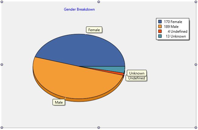

Basically, I have a simple query that returns the following result set that I would like to be able to feed into a pie chart at run-time. Here is what I get when I manually edit the chart in Delphi Berlin 10.2 FMX and attach the query to it:
This is what the end result should look like. This is from design-time editing of the TeeChart.

So in trying to replicate this in code, I have started here:
With GenderChart do
    AddSeries(TPieSeries.Create(Self));
    Series1.DataSource := Q;          // Q is the query component
    // Now I need to hook the two columns up to the pie chart. Here's where it breaks down.
    Series1.XLabelsSource := 'Gender';
    Series1.XValues.ValueSource := 'COUNT of ALL';
I'm obviously not doing this right because when run the above code, nothing appears on the chart.
If you could point me to the place in the help files that speaks to this, or help me by just naming the properties I need to set to get the results programmatically that are shown in the example chart above, I believe I can do other charts like this from there.
Thanks for your patient help.
John

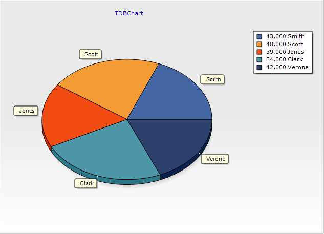

Here a simple test using "TeeChart Pro Database" shipped with the binary installation:
uses Series, DBTables;
var Series1 : TPieSeries;
    Q: TQuery;
  Q:=TQuery.Create(Self);
  Q.DatabaseName:='TeeChart Pro Database';
  Q.SQL.Add('SELECT LASTNAME, SALARY FROM Employee');
  Series1:=DBChart1.AddSeries(TPieSeries.Create(Self)) as TPieSeries;
  Series1.DataSource:=Q;
  Series1.XLabelsSource:='LASTNAME';
  Series1.YValues.ValueSource:='SALARY';
  Q.Active := True;
